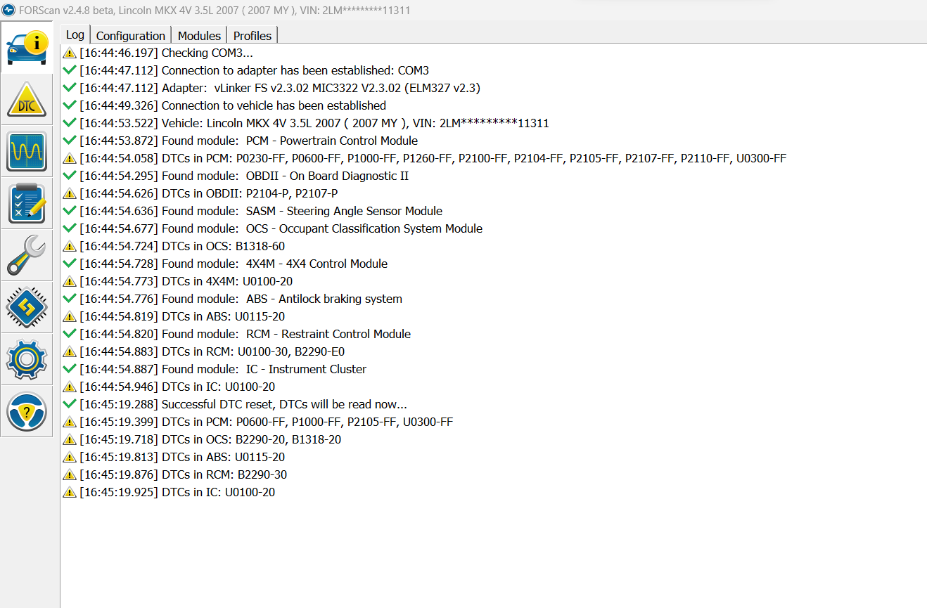

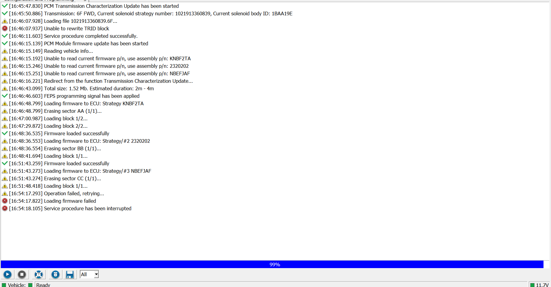

Strategy 3 totaly failded, car does not start again.....
just right after a valve body change.
now i got a P06600 code but i can acces to computer
I will add the log later....
It look like strategy 3 failded around 98%
PLEASE HELP ME MY CANNOT START

(OK) [16:45:47.830] PCM Transmission Characterization Update has been started
(OK) [16:45:50.886] Transmission: 6F FWD, Current solenoid strategy number: 1021913360839, Current solenoid body ID: 1BAA19E
(WARN) [16:46:07.928] Loading file 1021913360839.6F...
(ERR) [16:46:07.937] Unable to rewrite TRID block
(OK) [16:46:11.603] Service procedure completed successfully.
(OK) [16:46:15.139] PCM Module firmware update has been started
(WARN) [16:46:15.149] Reading vehicle info...
(WARN) [16:46:15.192] Unable to read current firmware p/n, use assembly p/n: KNBF2TA
(WARN) [16:46:15.246] Unable to read current firmware p/n, use assembly p/n: 2320202
(WARN) [16:46:15.251] Unable to read current firmware p/n, use assembly p/n: NBEFJAF
(WARN) [16:46:16.221] Redirect from the function Transmission Characterization Update...
(WARN) [16:46:43.099] Total size: 1.52 Mb. Estimated duration: 2m - 4m
(OK) [16:46:46.603] FEPS programming signal has been applied
(WARN) [16:46:48.799] Loading firmware to ECU: Strategy KNBF2TA
(WARN) [16:46:48.799] Erasing sector AA (1/1)...
(WARN) [16:47:00.987] Loading block 1/2...
(WARN) [16:47:29.872] Loading block 2/2...
(OK) [16:48:36.535] Firmware loaded successfully
(WARN) [16:48:36.553] Loading firmware to ECU: Strategy/#2 2320202
(WARN) [16:48:36.554] Erasing sector BB (1/1)...
(WARN) [16:48:41.694] Loading block 1/1...
(OK) [16:51:43.259] Firmware loaded successfully
(WARN) [16:51:43.273] Loading firmware to ECU: Strategy/#3 NBEFJAF
(WARN) [16:51:43.274] Erasing sector CC (1/1)...
(WARN) [16:51:48.418] Loading block 1/1...
(WARN) [16:54:17.293] Operation failed, retrying...
(ERR) [16:54:17.822] Loading firmware failed
(ERR) [16:54:18.105] Service procedure has been interrupted

Upgrade to 2.4.9beta and see if that helps? FORScan 2.4.8Beta had some bugs in the older PCM Strategy files writing which were reported to be fixed in 2.4.9 according to the 2.4.9 change log! Also Make sure your vLinker FS is on the latest firmware update!
This is still beta software and these Early HSCAN PCM's Firmware Updates are still in the very experimental stage so you are still doing these at your own risk!

Your adapter defaulted to 3 mbps as per your screenshot which looks too high. HS CAN operates in the kpbs range. I would download the newest version of ForScan and try locking in a lower baud rate (115 kbps) . Your current adapter settings might be incapable of negotiating a necessary network speed to complete the task is my guess.

I have the same error that i get stuck at 98%, did you solve it?
