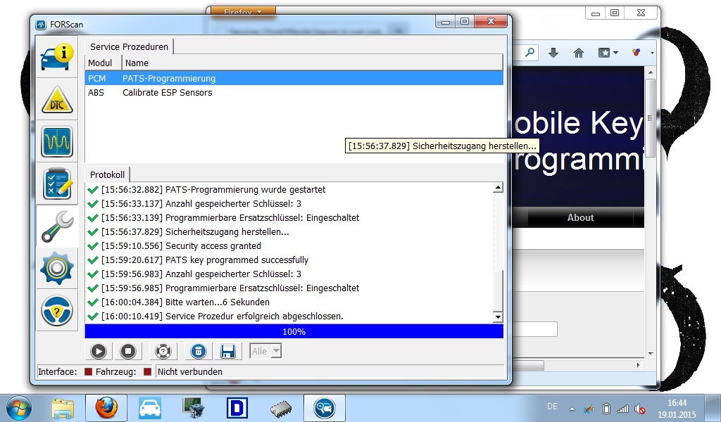

Hi Guys. I have a big Problem and hope somebody can help me out of it. I have complete the whole PATS programming thing with my Ford Mondeo Mk3 and in the End of all Forscan says its all successfully. But i can´t Start the Car with the Key that i habe used to programm with Forscan... What´s wrong?? I don´t want to go to the Ford Dealer for this... Btw, i have only One Master Key
Re: PATS programming will not work
What is the number of keys vehicle knew before your started the procedure, and after it? According to the log you posted, the numbers are 3 and 3. The successful messages from FORScan mean that PCM said OK when you programmed the key, however if the number of keys known is not changed, it means it was not really added. It is very weird.
One more thing: when new key is programmed, the master key needs to be moved far enough from the ignition lock, otherwise PATS may "feel" the master key and not the new key.

Are you sure you followed the procedure?
Your using an OEM PATS key? Not one of those clone ones?
If you started with 3 keys, and it still shows 3, you didn't program it.
We tested this function a lot on Mondeo 3 with original keys and cheap china clones, it worked fine with both types. The only thing is that it was Mondeo Duratorq-TDCi. Procedure for gasoline engines is just slightly different than for TDCi, it was tested on 1.8 Zetec (the procedure is the the same as for Duratec). We will try to test more on gasoline engines. Also, we would appreciate if you emailed you FORScan logs of your failed PATS programming session (instruction is on the Contact Us page).
