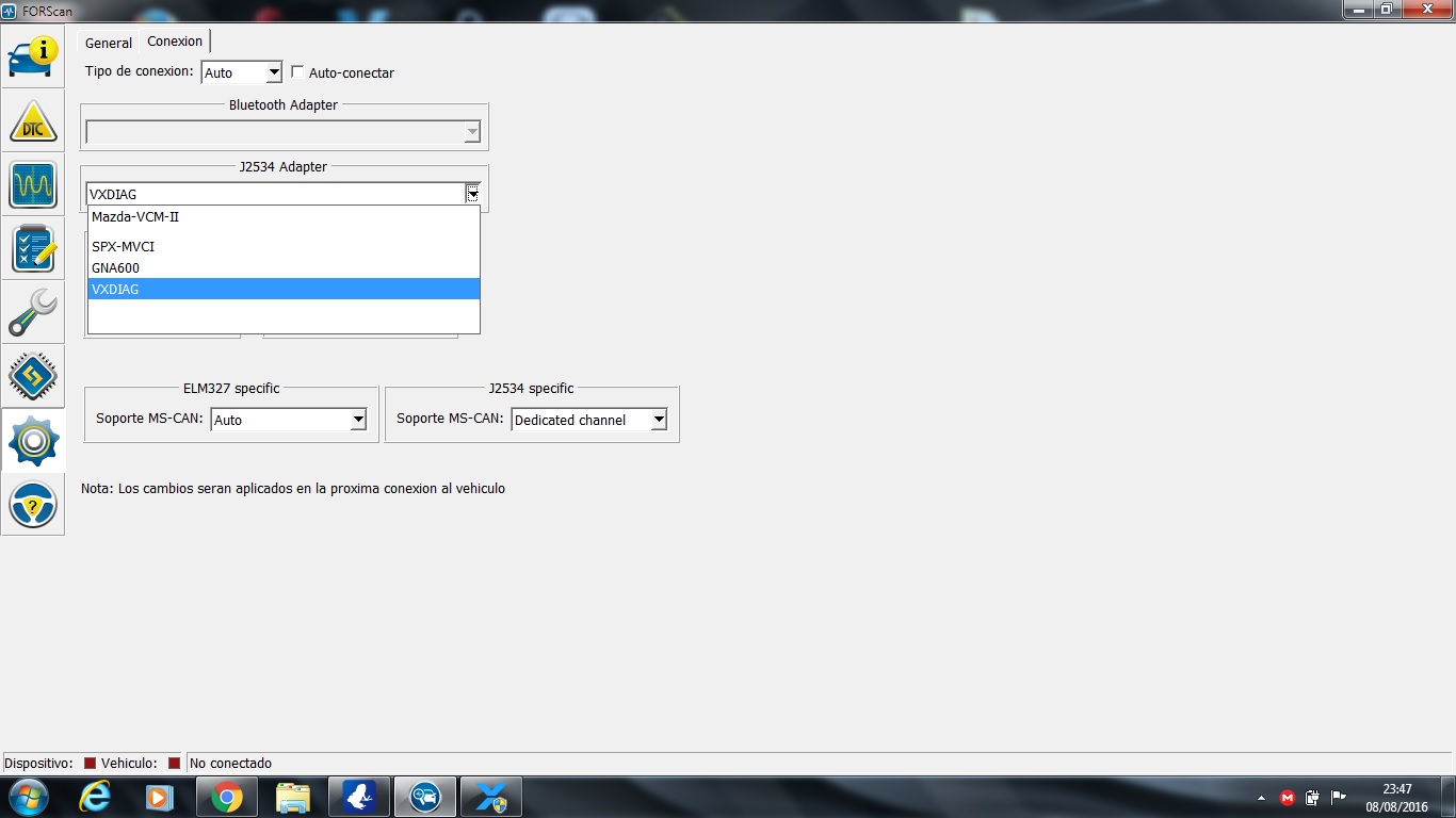

Revolter wrote:Hi, I have got the VCX nano, unfortunately I can't get FORScan to work with it, it finds it but not connecting to my car which is ON. I have proximity key, no manual key and it is in the car, tried also have car runnning but no change, can anyone tell me how to set FORScan to detect and work with VCX nano?

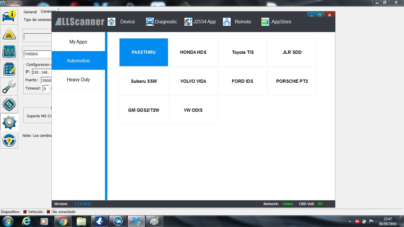

First of all install VCXManager and this driver:
And second configure ForScan how this image:
Its run perfectly
Update your VCXmanager and drivers to the lastest version
