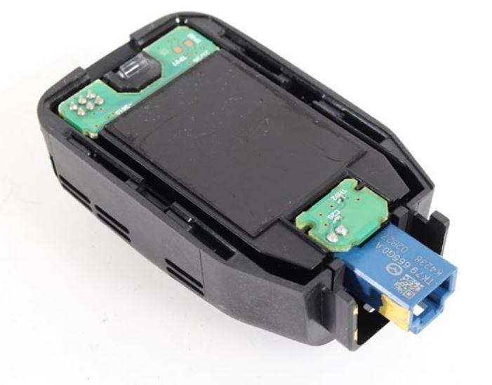

I was trying to retrofit the auto-light function on my Mazda 3 2018 hatchback, it comes the sensor on windshield.
Did the AS-Built configuration and install the auto-light wiper and auto-rain wiper, archived to active the auto-light sensitivity and rain sensor activation function on the MCU.
Dig to more details, i found out the similar sensor on windshield is only having the function of humidity. this sensor part number is TK78665G0A, with black connector.
Just order other TK79665G0B with blue connector, will share if it works.
Attached the picture i found on internet, the termination A or B, doesn't mater.

HI. I HAVE MAZDA 3 I-TOURING 2018 2.5, PLACE LIGHT SWITCHES AND SWITCHES WINDSCREENS AUTOMATIC’S, PLACE RAIN SENSOR Rain Sensor - Mazda (TK79-66-5G0B). THE LIGHTS TURN ON AND THE WINDSCREEN WIPERS WORK BUT THEY DO NOT TURN OFF. IS IT NECESSARY TO PROGRAM THE FBCM AND RBCM? HOW IS IT SCHEDULED?

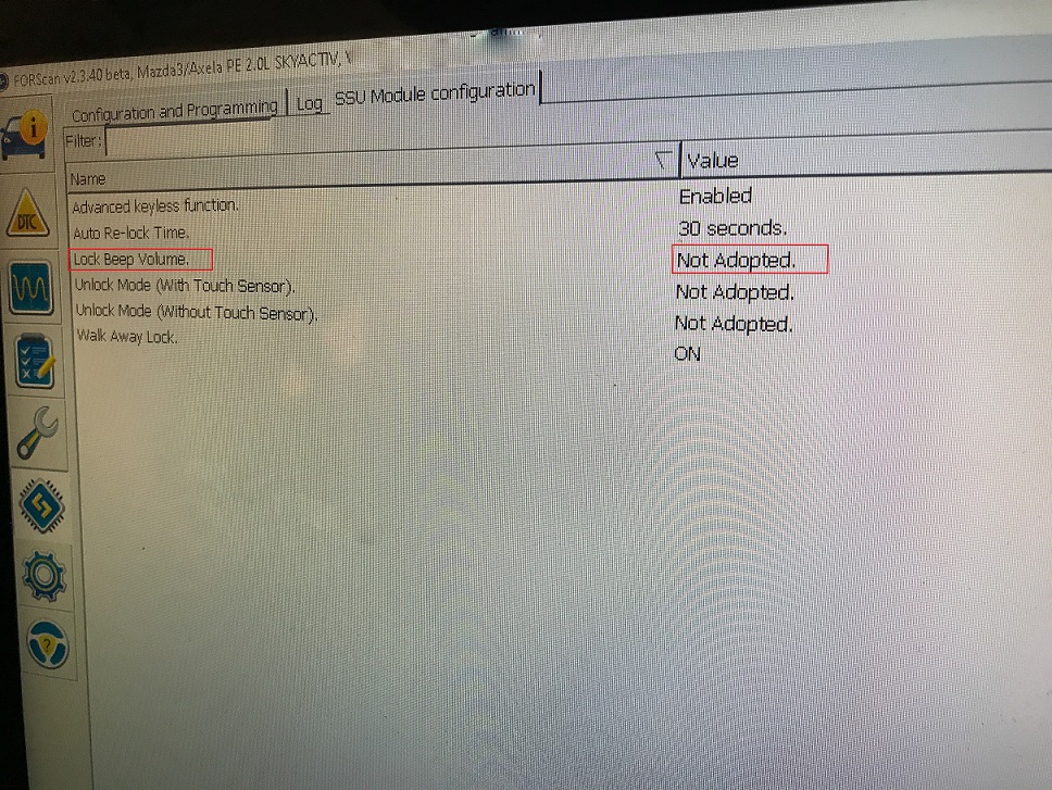

hello guys.
I'm new user with forscan may you help me!
I have ( Mazda 3 2015 Axela PE ) and I need to turn on lock beep volume (I MEAN I NEED TO HEAR HORN WITH LOCKING DOORS BY REMOTE) but when I get the SSU Module Configuration I found:
Lock Beep Volume. Not Adopted.
when I try to turn ON >>> it gives me error !!!
There is anyway to fix this by SSU ASBuilt Configuration ? or can you explain to me what is that meaning if you can ?
Is that means my car's horn not connected with the computer? If it is true, Is there anyway to connect it ?
Thank you,,,

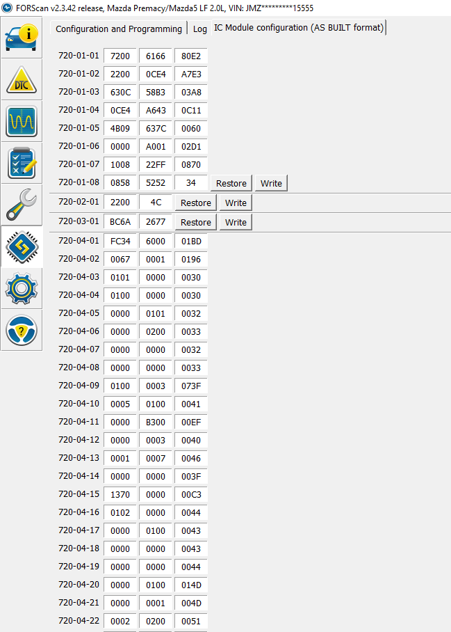

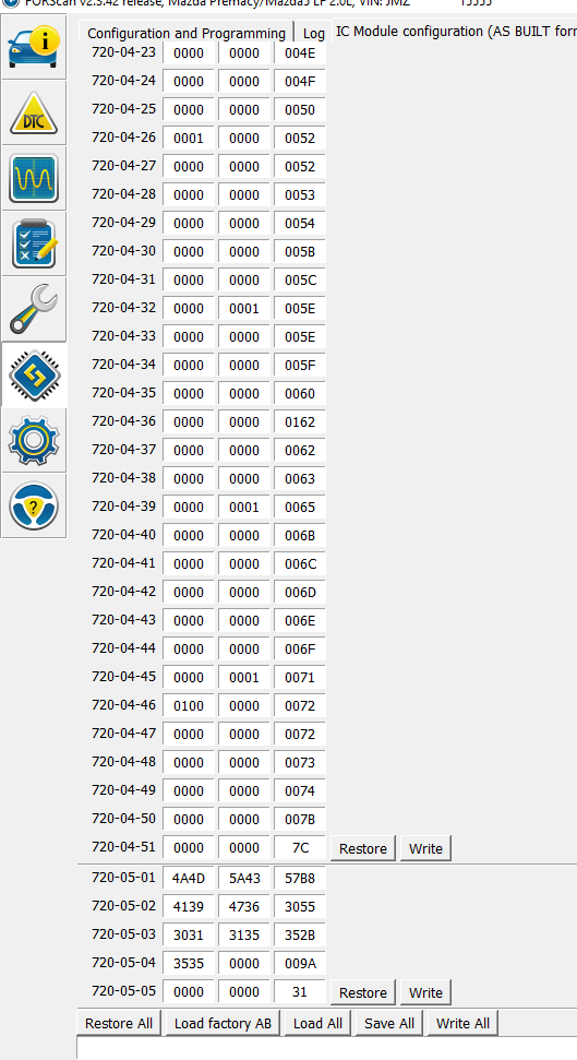

We have a mazda premacy 2016 2.0 SkyActive, there is a standard cruise control, but the limiter is set to 105 km / h, in the row 720-04-23 there are parameters 0000 0000

Hi Alexnt,Alexant wrote: Mon Oct 17, 2022 9:17 am guys, everyone, tell me can you help
my Mazda 5 is 2011, not Skyactive, but 2,0 DISI (europe model).
Don't know does it make it a "different" car, but my cruise doesn't have limiter and 720-04-23 is 000 0000 004E
btw. does the Skyactive as-built list work for your car? Or have you founded any enable/disable functions?
I have founded only how to have enable/disable "scandinavian mode" for outside lights. When it's enabled, all outside lights turn on when engine is on.

hello friend, I have not yet found how to turn off the limiter on the cruise control, can I throw off the screen from IC and if possible compare with yours, if you can send it too?Fin.Maikel wrote: Wed Nov 16, 2022 1:48 pmHi Alexnt,Alexant wrote: Mon Oct 17, 2022 9:17 am guys, everyone, tell me can you help

I've attached my IC As-built pictures.Alexant wrote: Thu Nov 24, 2022 7:49 am hello friend, I have not yet found how to turn off the limiter on the cruise control, can I throw off the screen from IC and if possible compare with yours, if you can send it too?

friend, thank you very much, you are the best, one of these days I will look at what I have thereFin.Maikel wrote: Thu Nov 24, 2022 11:49 amI've attached my IC As-built pictures.Alexant wrote: Thu Nov 24, 2022 7:49 am hello friend, I have not yet found how to turn off the limiter on the cruise control, can I throw off the screen from IC and if possible compare with yours, if you can send it too?
