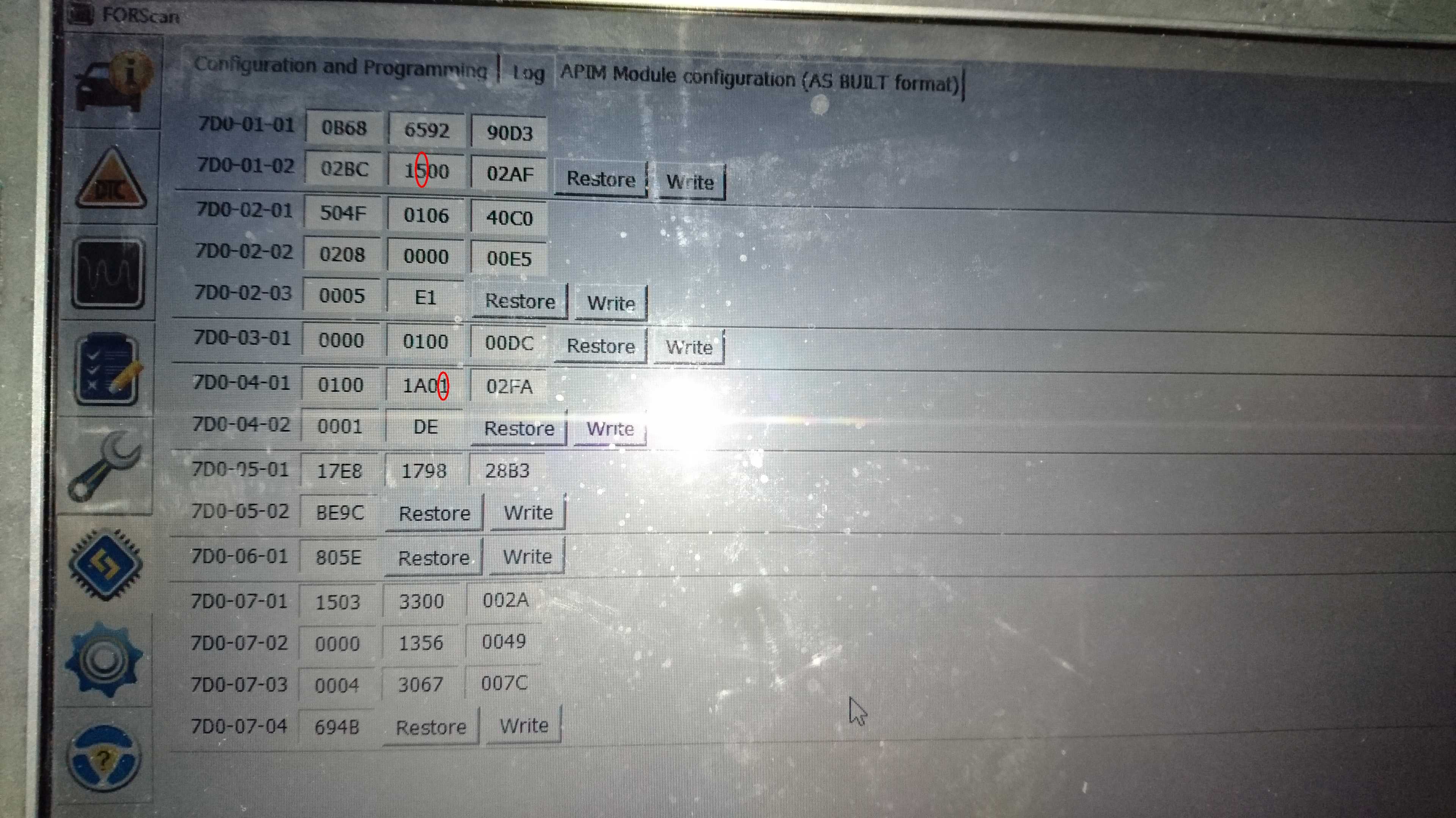

Thanks to murat_kavuk, i got climate working on touch screen, without any negative side effect. These were the instructions:
7D0-01-02: xxxx x3xxx xxxx - Climate button + climate voice control
7D0-04-01: xxxx xxx0 xxxx - To see set temperatures on main screen (shortcut to climate setting window is climate button enabled)

Re: ADD CLIMATE
Yes it is, just change whatever value you have to the number in that specific position and you will have climate control working on the touch screen + temperature voice control. I have attached a print of my Apim module before the changes and marked the values that have to be changed. Tell me If you need any additional help.Cosmicbase wrote:I have a Ford Focus 2017 facelift 1.5l Tdci with sync3metalzone wrote:Thanks to murat_kavuk, i got climate working on touch screen, without any negative side effect. These were the instructions:
Which module do I have to take in Forscan?
APIM???
- Apim Module Climate II.jpg (728.4 KiB) Viewed 12805 times

Re: ADD CLIMATE
I have dual zone Climatic. You toometalzone wrote:Yes it is, just change whatever value you have to the number in that specific position and you will have climate control working on the touch screen + temperature voice control. I have attached a print of my Apim module before the changes and marked the values that have to be changed. Tell me If you need any additional help.Cosmicbase wrote:I have a Ford Focus 2017 facelift 1.5l Tdci with sync3metalzone wrote:Thanks to murat_kavuk, i got climate working on touch screen, without any negative side effect. These were the instructions:
APIM???
Ford Focus 2017 (DYB) 1,5 TDCi 120PS with sync3 Navi
