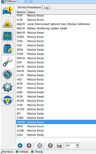

Hello, after reading more post about the PATS function, I wonder why I can not detect the function with my mazda 6 2.0L of 2005 (LF)? I try with 1 different ECU a 2.3L (L3) with OPENPORT 2.0, ELM 327 1.4 USB and an ELM 327 1.5 Bluetooth. Will it be developed ? Tanks

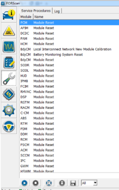

Does FORScan 2.3.5 support PAT programing to Ford EDGE 2016 model?
I try to follow the steps mention in your post, connect ELM327 to my EDGE and powered it on then run FORScan to read all modules, then go to service button, but when I faced to following modules I found that Icompletely lost myself. There are so many modules and I have no any ideas which one will be used to program the key?
Thank you for your kind attention!
