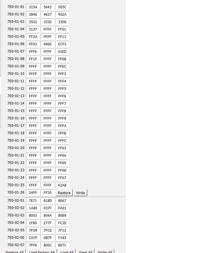

I have a canadian spec 2014 Ford Mustang GT. I found a spreadsheet online and a forum post explaining how to to that, however, I noticed the BCM lines are quite different.
I attached a screenshot for reference.
I recently changed to 4.10 gears and my tires are 245/45/19. In Forscan, I have two options either modify BCM lines or the other human-friendly option, but max gear ratio I can set is 3.73 and I have bunch of tire options to select from, to compensate for difference between 3.73 and 4.10 I chose the biggest tire circumference I could find from the list. After doing that, still I have a 10kmh (6mph) difference so my speeding is reading higher, which is better than reading slower at least.
I'm trying to adjust it further to make it close to regional specs (speedo must read 3~6kmh slower). I compared the BCM lines before and after changing the tires and used ChatGPT/Google Sheets to figure something out ... no solution found :(
