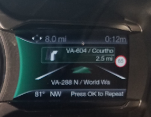

Re: Ford As Built Data Deciphering
I added the AWD module and engine hours gauges. Some other odd things came up as a result. One, there's the little speed limit indicator that shows up in my nav pane now that wasn't there before, and, one of my left side gauges (miles remaining maybe) used to have an RPM gauge along with the fuel gauge, the RPM is now gone, just fuel. I have seen a pic where someone posted their AWD screen and it has the RPM gauge, I'd like that. Any ideas? Played with the DRL setting in that module, but these were the only IPC changes made.
Here are the settings I updated:
720-01-02 8AF8 6F70 3DC8 (OEM)
720-01-02 BAF8 6F73 3DFB (MOD)
The 8 to B enabled the AWD screen, the 3 in the second data block enabled the hours count screen. Any clues as to how to enable the RPM gauge, or why the speed limit indicator came on?
Also, there are two gear indicator icons, a big one in the tach cluster and a smaller one that sits in the lower shaded area where the odometer is. Any way to make the smaller one permanently on?
