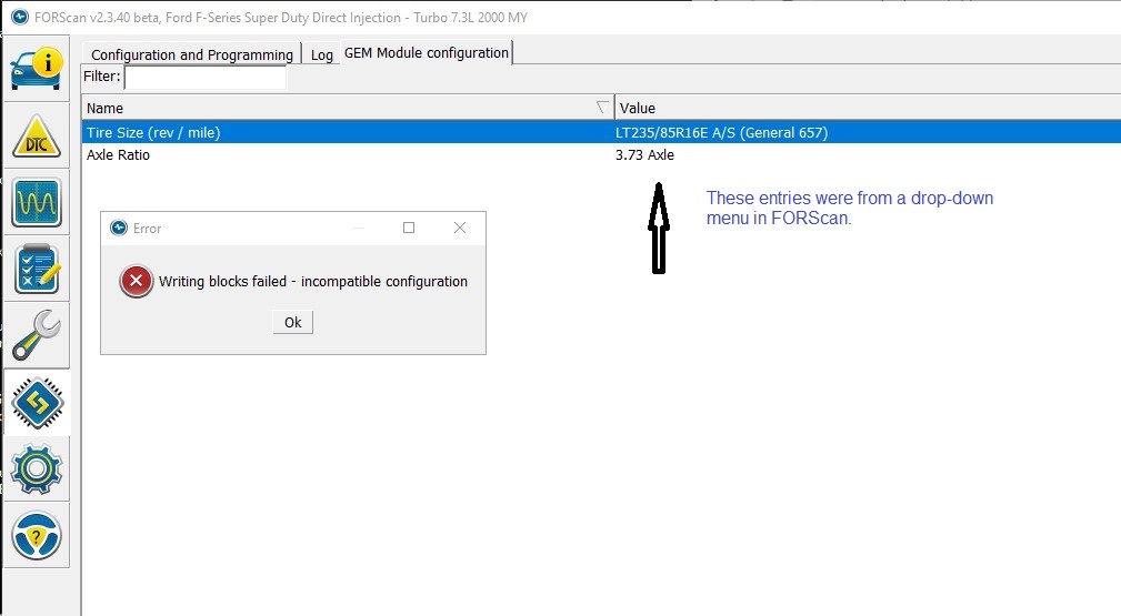

Using v2.3.40 -- clicking on the item gives you a drop down menu.
However, choosing in the drop down does not work. I assume the choosing of the item would send the proper parameters to the GEM, but it is not.
Writing to GEM 1 Notation 2021-05-19 143849.jpg (79 KiB) Viewed 10873 times

If the vehicle you are trying to program is the 1999 F350, then it's probably because your vehicle is too old for Forscan to perform this ability. Doubtful if Forscan can do anything to that vehicle's limited computer.
