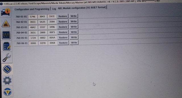

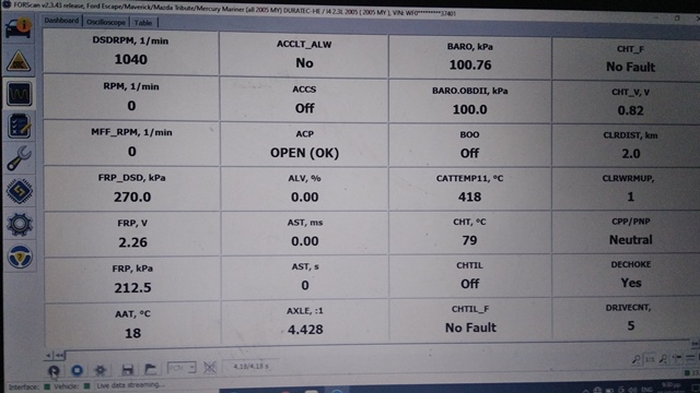

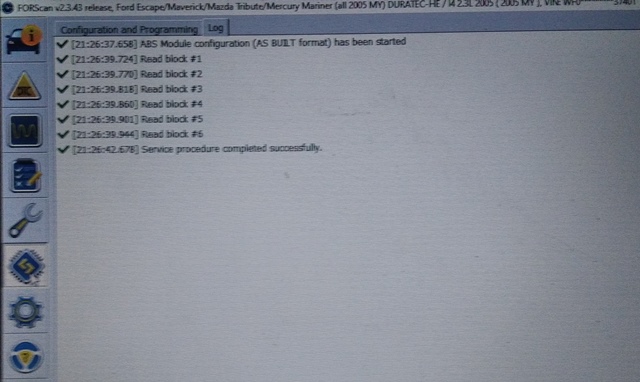

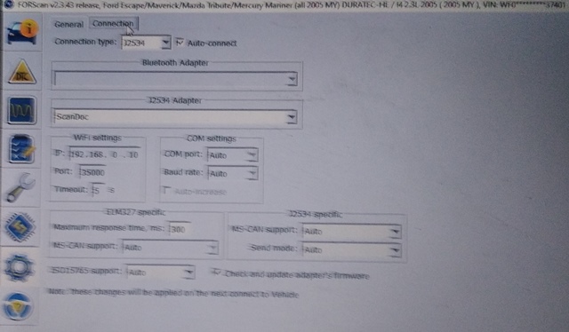

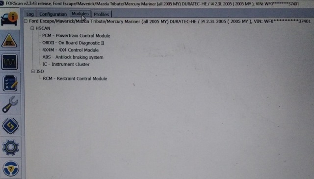

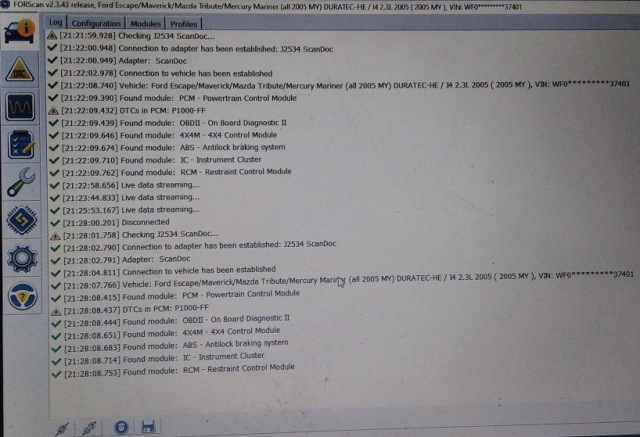

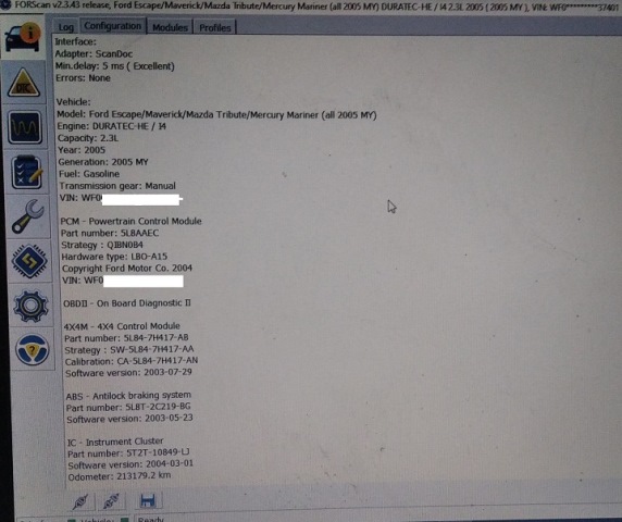

J2534 Adapter with potentian diagnostic usage.
I state my experiance with J2534 adapter ScanDoc from quantexlab.com
I tried to coding with "as build data" an used ABS unit. Ford Maverick year 2005
This adapter made it Successfully, but I mention that has also diagnostic usage DTC, Reset Unit, Data list etc.
I go to investigate further this adapter.

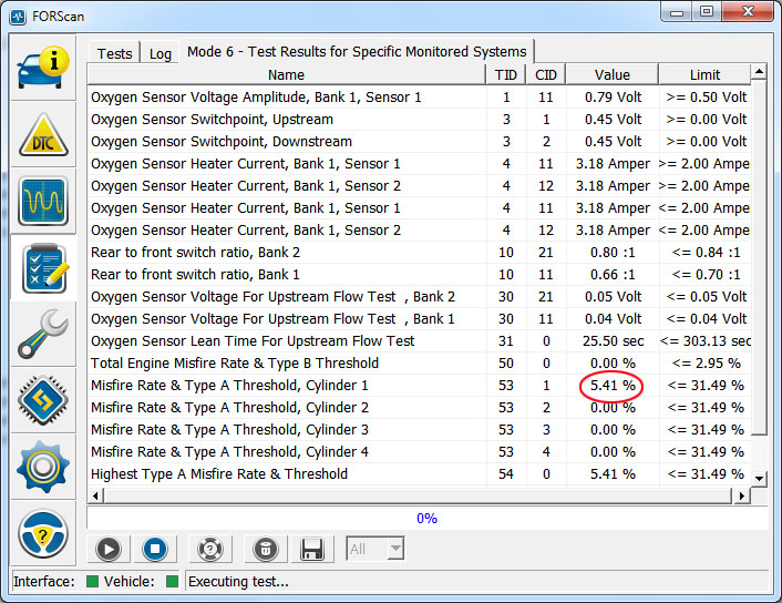

Report of non Continuous DTCs as reported by the Mitchell MD-350. FORScan does not know what multiples of these tests are - gives incorrect data output. I will update this with the list of DTCs from FORScan later today for comparison.
Re: Support of J2534 (Pass-Thru) adapters in FORScan v2.2.*
jSONBB wrote: Thu Jan 05, 2023 8:50 pm nonContinuousModeDetailedReport_2002__Ford__Escape__GLOBAL_OBDII__01052023152506.pdf
This is how MODE 6 is identified with FORScan with a J2534-2 device and Bluetooth adapter.
You are incorrect trying to operate that tool, all it did is generate a report from itself, NOT FORScan!
Misfire mode6.jpg (227.98 KiB) Viewed 15644 times
