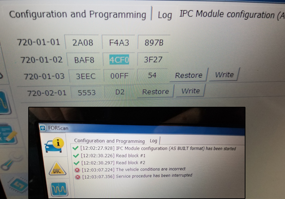

Good afternoon all, stumbled upon this post while looking for ForScan mods for my 2013 Ford Taurus SHO. My car is a PP with the 401a technology package, so most of the hacks that I found I already have.
I am especially interested in the AWD monitor, and would love to view the TPMS individually but from what I am ready it is only for 2015+? Bummer.
I tried the code change in the the first couple of posts, but could not get the changes to take effect. I get an error upon trying to write the code. Any ideas?
