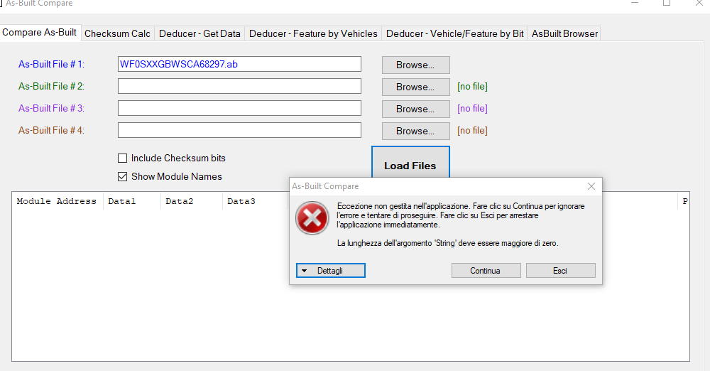

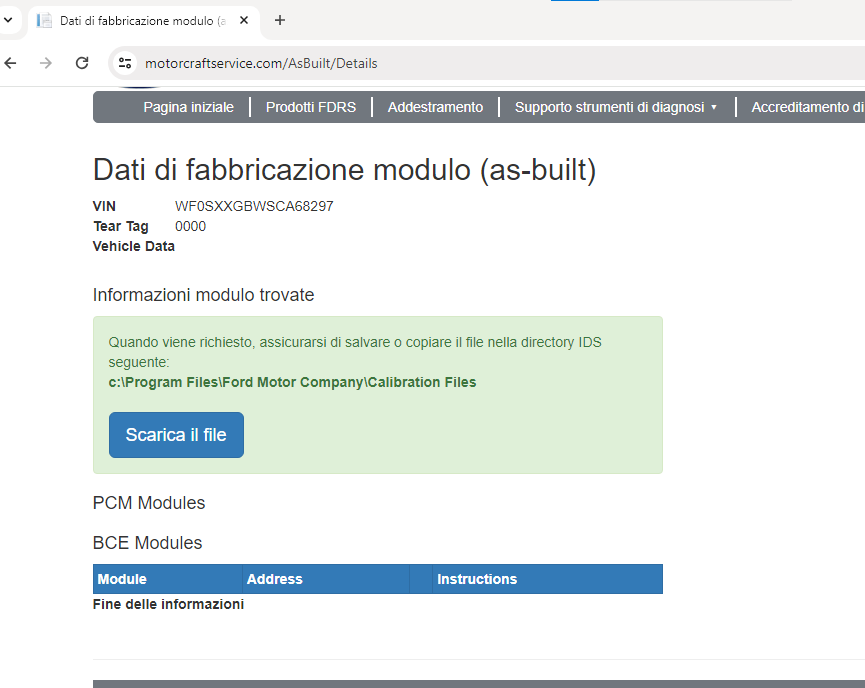

BUONGIORNO
qualcuno mi aiuti mi serve il file ab per ford s max 2.0L 163CV 2012
vin WF0SXXGBWSCA68297
NON riesco a trovarlo da nessuna parte ho scaricto piu volte dai link che ho trovato sul forum ma non ha informazione
o se qualcuno lo ha a pagamento non ce problema lo acquisto
per favore
grazie
WF0SXXGBWSCA68297.ab
per favore
grazie

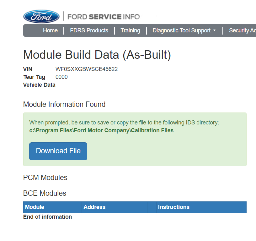

Hi, please could somebody send me the as built data for my 2012 S Max 2.0 (163) powershift?
The VIN is WF0SXXGBWSCE45622
Motorcraft is just giving me blank results

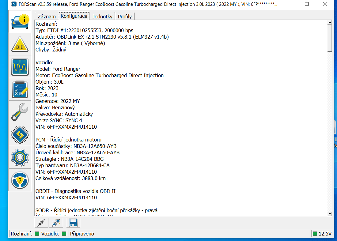

Hello, you don't know where to get the FORScan table for the Ranger Raptor 2022MY
- 22.PNG (113.34 KiB) Viewed 7918 times

For AsBuilt try here and find and use the AsBuilt link about half way down the Page: https://www.motorcraftservice.com/quick ... uickguidessloon wrote: Sun Mar 31, 2024 5:41 am Hello, you don't know where to get the FORScan table for the Ranger Raptor 2022MY
If you are not in North America you may have to go through the Home page https://www.motorcraftservice.com/ and chose Canada or the US as your country then open "Free Resources/quick guides and find the "AsBuilt link and open it and type your VIN into the VIN field!
It should return a very long list of the vehicles Modules by Module Hex address(I tried it using the VIN in your Attachment, it is there)!
I usually Save the web page by using your Browsers Print button and "Save as PDF" as well as downloading (using the "Download Button"), the file and down load it directly to or copying it to the "FORScan Calibration Files folder in your Documents Folder!
If you mean a spread sheet you will have to do a Google search for Ranger Enthusiast Forums and see if any one is working on one! These are links to a couple of them but they are US based https://www.fordranger.net/ https://www.ranger5g.com/forum/
That is all I can offer!

Thanks for the reply, I meant the units adjustment table.
