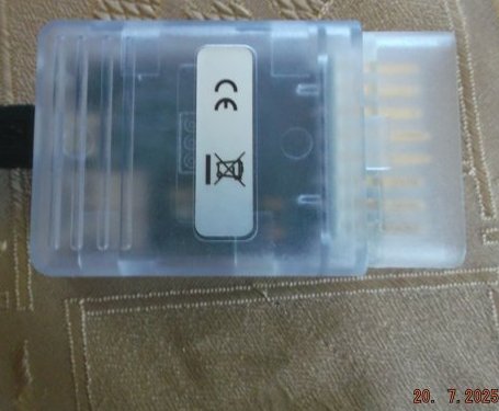

I was given a J2534 but have no idea what type it is.
Is there a way to work this out, so I can get drivers to use with my 2024 Mazda Skyactive 2.5 litre petrol
Australian 2006 Mazda 6 Wagon MZR-CD Turbo Diesel

2007 MZR-CD wrote: Sat Jul 19, 2025 12:16 pm I was given a J2534 but have no idea what type it is.
Looking at the images of the device in my crystal ball, I'm going to guess it's a J2534 device that you don't have drivers for.
You need to provide photos. If you are having troubles attaching them, come back later. At times, there might be an error saying upload limit has been reached. A google reverse image search might also work.
Loading photos to cloud storage & providing a link is also a good option when attaching files isn't working.
Adding every piece of detail on a label could help too if you are still struggling to add photos or a link, but less likely to help if it's a little known device.

I hope these pictures help!!
J2534 dscf2460.jpg (32.74 KiB) Viewed 5010 times
J2534 dscf2459.jpg (28.84 KiB) Viewed 5010 times

Looks a lot like a dodgy Tatrix clone. These have been known to fail & brick modules.
If it is, it will only find modules on HSCAN & is unsuitable for most FORScan programming, code checking etc.
You could test by downloading the drivers & J2534 DLL & see if it is recognised in device manager & FORScan. Keep in mind that even the original Tatrix are limited. https://www.tactrix.com/downloads/openp ... 024820.exe
To be honest, i'd buy a vLinker FS USB cable before I'd trust a Tatrix clone.
