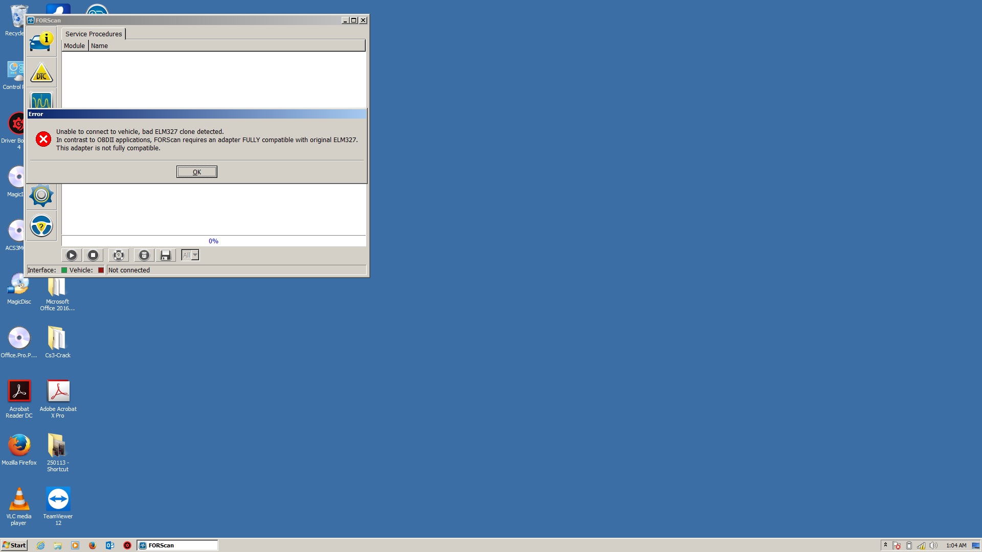

My clone of the ELM 327 worked initially. Before I modified it, it reported information off of the HS CAN bus and OBD data. After my initial modification, it reported MS CAN information as well. However the switch I used was too big so I changed it to a smaller switch and now Forscan reports it is a "Bad clone" and it does not work at all. The 'AT' commands listed in this post all return non-error results. The pins and wires have proper continuity from the connector to the PIC chip controller when tested with a meter, in both switch positions.
I think my modification must be the first change to look at. Is there a specific 'AT' command or test I can do to confirm communication with the MSCAN or HSCAN bus? Is there a way to bypass Forscan's proclamation that it is a bad clone so I can continue to test it?

I rewired my ELM327 clone modification and the unit works properly now. Forscan only returns one unknown command in the log. Is there any way to tell which command is unknown?
