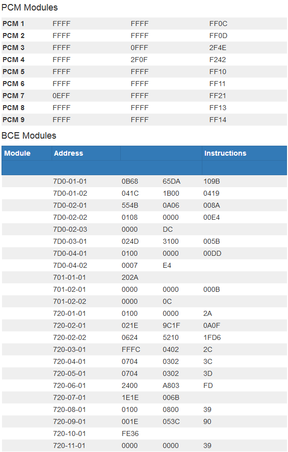

Hello, i activate HSW and seat heating. I see the buttons on the screen. But somehow it does not work.metalzone wrote:I have found more information about it, from another fórum, just replace the big X for one of the values below:
Credit to:
DanMc85 Wrote:
APIM:
7D0-01-01: xxxx xxxx xXxx
3=Heated Seats
2=Heated/Cooled Seats
7=Heated Steering Wheel and Heated Seats
6=Heated Steering Wheel and Heated/Cooled Seats
7D0-01-01 xxxx xxxx x7xx ---> 7=HSW & Heated Seats
HSW & Heated/Cooled Seats: 3=Heated Seats only, 4=HSW climate screen only, 7=HSW & Heated Seats, 6=HSW & Heated & Cooled Seats, 5=HSW & Cooled Seats, 2=Heated & Cooled Seats, 1=Cooled Seats, 0=None
That's my equipment:
SYNC3 3.0 with Navi an Dual Zone Climatic, HSW & Heated Seats
The buttons are available but the heated steering wheel and heated seats can not be switched on. Manual via button everything works.
Could someone take a look and photograph the line?
Ford Focus 2017 (DYB) 1,5 TDCi 120PS with sync3 Navi

ok i have read a uk spec sync 2 with climate & heated seats only working from factory to forscan and got this
And the other is from sync 3 with no climate and heated seats added to screen from factory maybe someone can sort out what wrong and how to remedy this for uk
