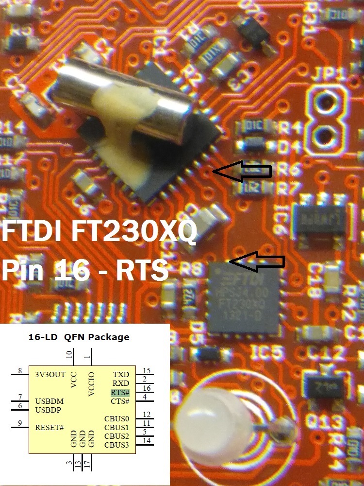

Went to do the mod to my adapter, but the inside is totally different.
Here are some pics of the red rev. J board it it helps anyone.

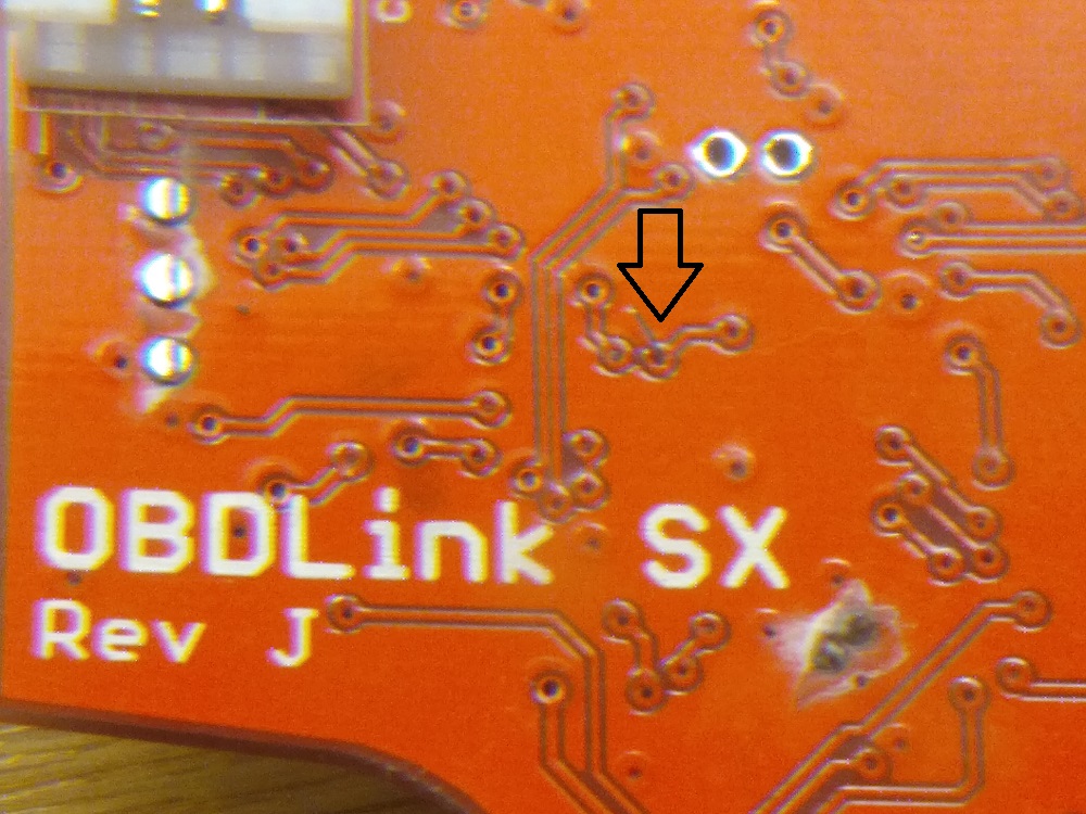

Re: Modifying an OBDLINK SX USB Adapter for HS/MS-CAN relay managed by RTS
I have a rev. J board also and just started modding it. I pulled up the data sheet for the FTDI FT230XQ. Pin 16 is the RTS pin. The trace is very small but it seems like I could solder a very fine wire to it. In the second picture, I inserted a small wire through the hole near the PIC chip. I think I will try scratching a little bit of the coating off of the via hole on the back side and soldering there.fxnick wrote: Sat Nov 09, 2019 1:29 am Went to do the mod to my adapter, but the inside is totally different.
