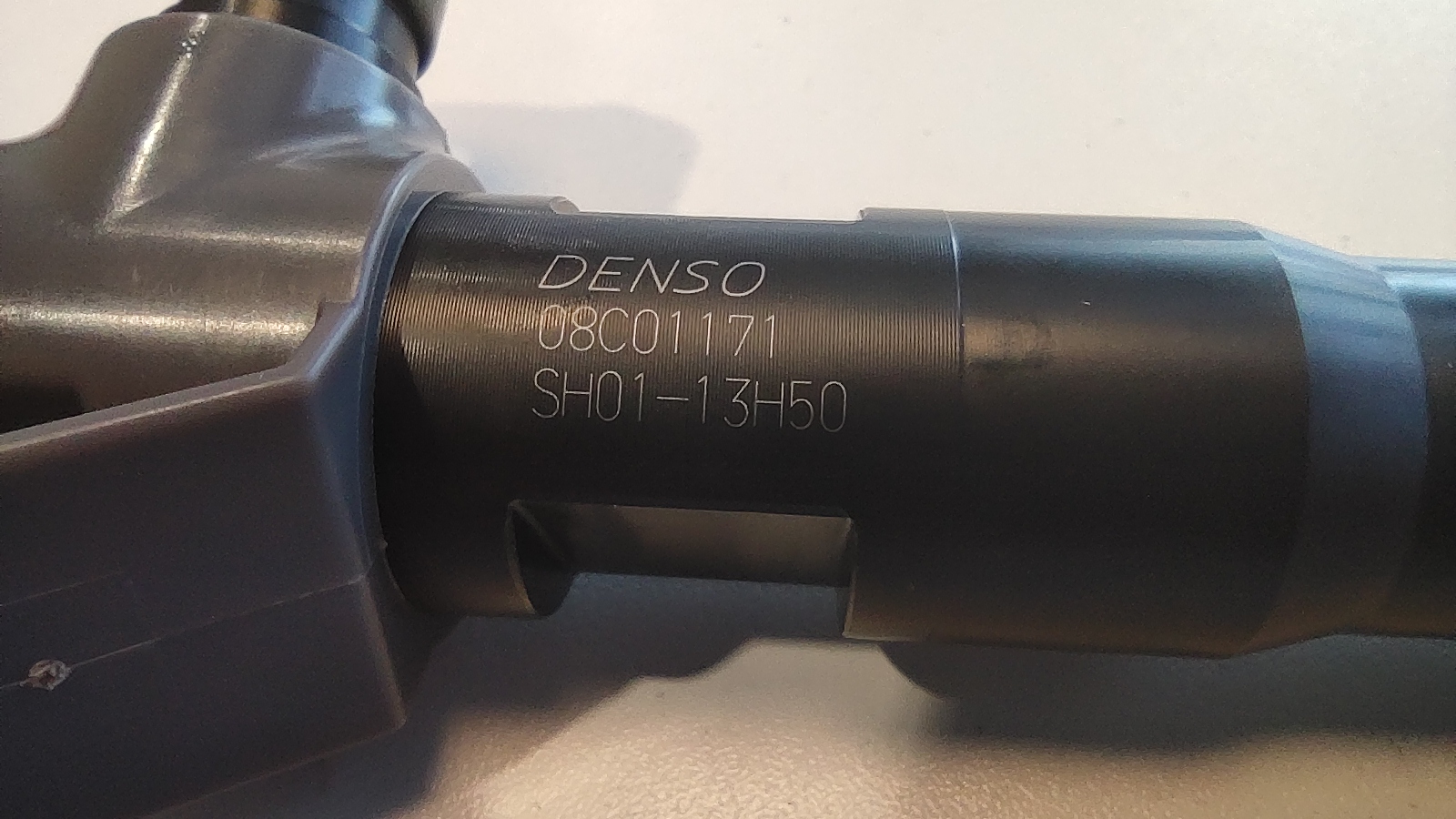

Re: Mazda CX-5 2.2 SkyActiv-D - DPF filling fast
This one of the new injectors I had fitted showing the Denso/Mazda part number. They are not reconditioned but new, the whole job costing over £3000 before contributions by Mazda and Dealer and discounting due to it being charged at warranty rates which brought it down to £2000 and change.
I very much doubt if Mazda are going to be that generous now, particularly on a model that is no longer in production and it been found out that its a material issues by Denso, which Mazda seemed to be aiding and abetting.
The problem was random across the two models Cx5 and M6 both sharing the 2.2D engine and thus the same injectors.
If the smaller diesels were not affected then it is down to a batch of nozzles, a large one at that as it also covers several years from 2013 model year up to at leat 2016.
