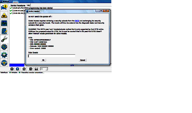

tried reading this post and others a lot of links not valid now and some sites also dead, so could someone advise me or repy with a good tutorial to program a 3rd key for my wifes Ford B-max 2013.
She managed to lose her key and now we have only one, so tried following the links and info and this is how far i got:-
Got ELM connected, licence upgraded, ran PATS selected add another key (still shows two) and it came back with an outcode but with an error message and I can't find a link to download or site to visit to get the incode?
Any help or guidance would be great
