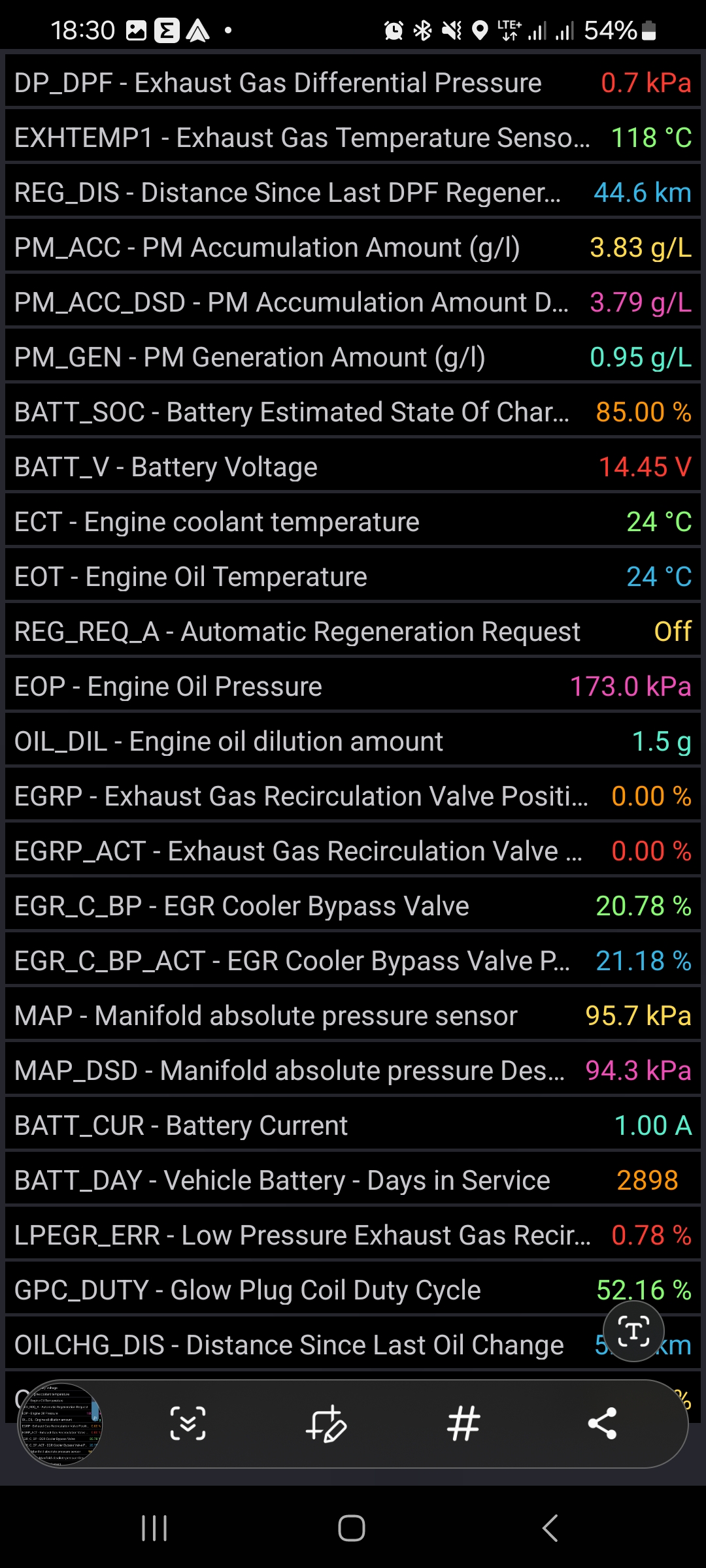

Hi DPF team,
The regenerations distance started to decrease gradually again from 140km to 60km. Note that now I'm at + 165k km.
I notice that often PM_GEN is less than 1 g/L but PM_ACC is reaching 6 g/L hence triggering the regeneration (I have the H sw)
Also I see that the EGR_ERR is at 99.22%, meaning the valve is not closing correctly from my research. Since the intake+EGR was cleaned this summer, I suppose that the EGR might not work properly.
Note that in July I checked the injectors at a specialized center and replaced that washers and the analysis resulted that there were no issues with the injectors.
As a sum-up of the actions I did in the last 2,5 years:
1. Cleaned the intake 2 years ago and this summer after 40k km
2. Cleaned the DPF a couple of time with Wurth DPF foam or similar inserted before the DPF - it helps, but it isn't last more than 2-3 months.
3. STP DPF additive helps usually by doubling the distance, but I'm afraid of abusing from it too much as it might damage the injectors nozzles
4. The H2 intake cleaning last year - it helped for a couple of months
I have now a chipped SW that gives me more torque and HP, I suppose this also increase the regeneration frequency.
Since the current calibration SW now is SH7M-18881-H I was thinking to change it to SH7M-18881-B and disable the EGR using a custom ECU firmware instead of trying to change the EGR.
If this does not work I should evaluate to sell the car and go for the Mazda with the AdBlue as from I heard it's a more robust engine (after August 2018 - in the back is has only one exhaust pipe)
Do you think my analisys make sense?!

Thanks Mareng, think the injectors are holding fine, the regens are the main thing ive noticed. Last one had a really long interval well over 200 miles. Injector correction values look good as well.
Zdaradova, I had the exact same and % error the EGR, but i think the egr just shows that error when they shut. I had mine cleaned out and they were still doing it, youll notice if you put the egr desired and actual on a graph that when you stop the vehicle and the egrs desired and actual go to 0% as it closes and the egr error goes to 99.2%. I think the error PID on this car just measures the flow. I could be wrong, i do get a rough idle and my car definitely felt better when i unplugged the egr, minus the limp mode.
