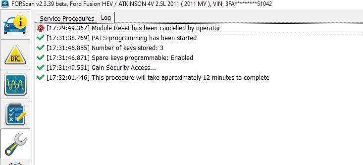

ahamedr_forscan
Joined: Wed Dec 09, 2020 8:25 pm
Vehicle: Ford Fusion Hybrid 2011
Re: How to program PATS using FORScan v2.3.*
Post by ahamedr_forscan »
2011 Ford Fusion Hybrid.
Bought with only one key.
For almost 3 years had only one key.
Previously bought Forscan to reset battery age. Hybrid is working.
Decided to get a 2nd key to avoid heading to dealer in case something happens to the one working key.
Was not comfortable erasing and programming keys.
After some reading found this thread and followed the instructions.
1) Start forscan, went to PATS programming.
Found 3 keys were already there, but I had only one.
2) Security access took 12 minutes.
3) Then, was prompted to remove working key, insert new key and turn it to ON and hit OK button.
4) Did that and got message that key was programmed successfully.
5) Message prompted to cycle the new key.
6) Key count now increased to 4.
7) Turned the engine and drove the car around fine.
I bought the key from Amazon and had programmed the fob earlier.
The first time I cut the key at Lowes, the key was messed up. After discussing with the Amazon seller, I got a replacement free and this time I cut it from a local locksmith.
My advice is to cut the key from an auto locksmith.
