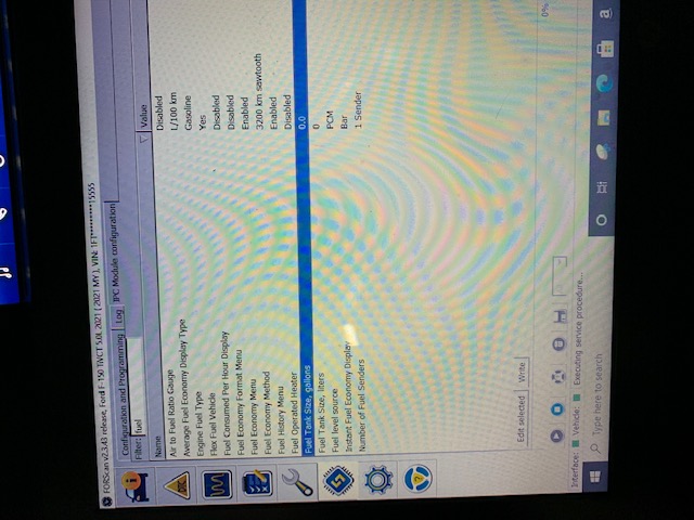

I followed the instructions in this thread, however when I get to the tank size dialogue box, I find both gallons and liters are set to zero. I've made the switch from the 26 to the 36 gallon tank, and don't know what to enter in the appropriate areas for the software to write to the ipc or pcm.
