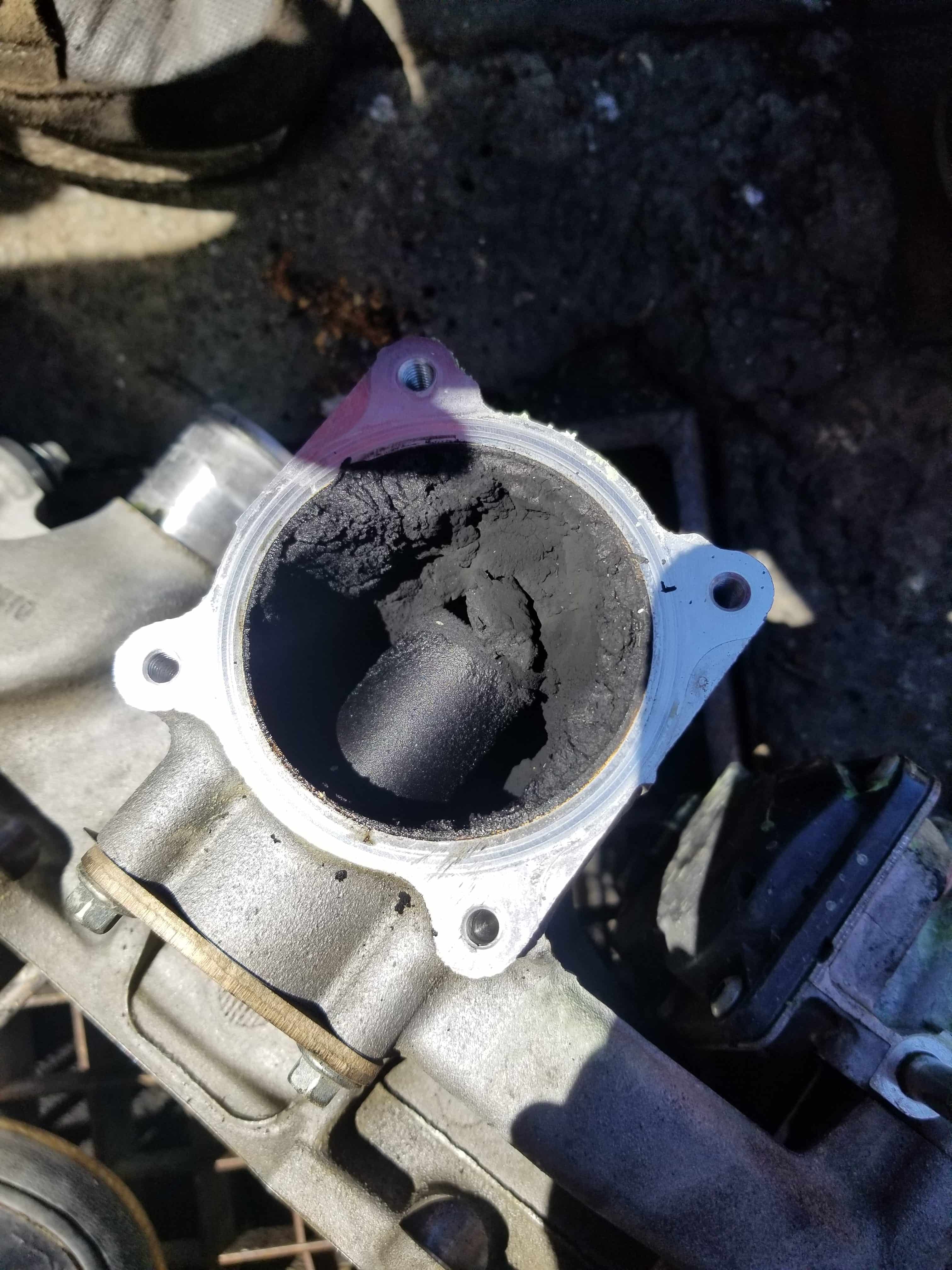

It seems like the worst case of clogging was on a vehicle that is only driven in the city with traffic and short trips.
I don't think you can prevent this from happening apart from not doing short and slow trips.
I think that cleaning should be done at about 100-120k km. The MAP sensor is located on the intake manifold and it will be full of carbon. I will provide some pictures when I get the time.

This is the extreme case of intake manifold clogging I talked about. Only about 50k km on the odo. This condition almost always triggers a P0401 or P0101 DTC.
I think that there's a huge story behind the SH engine.

OMG, that must be some extreme city driving that diesel wasn't made for...omg
