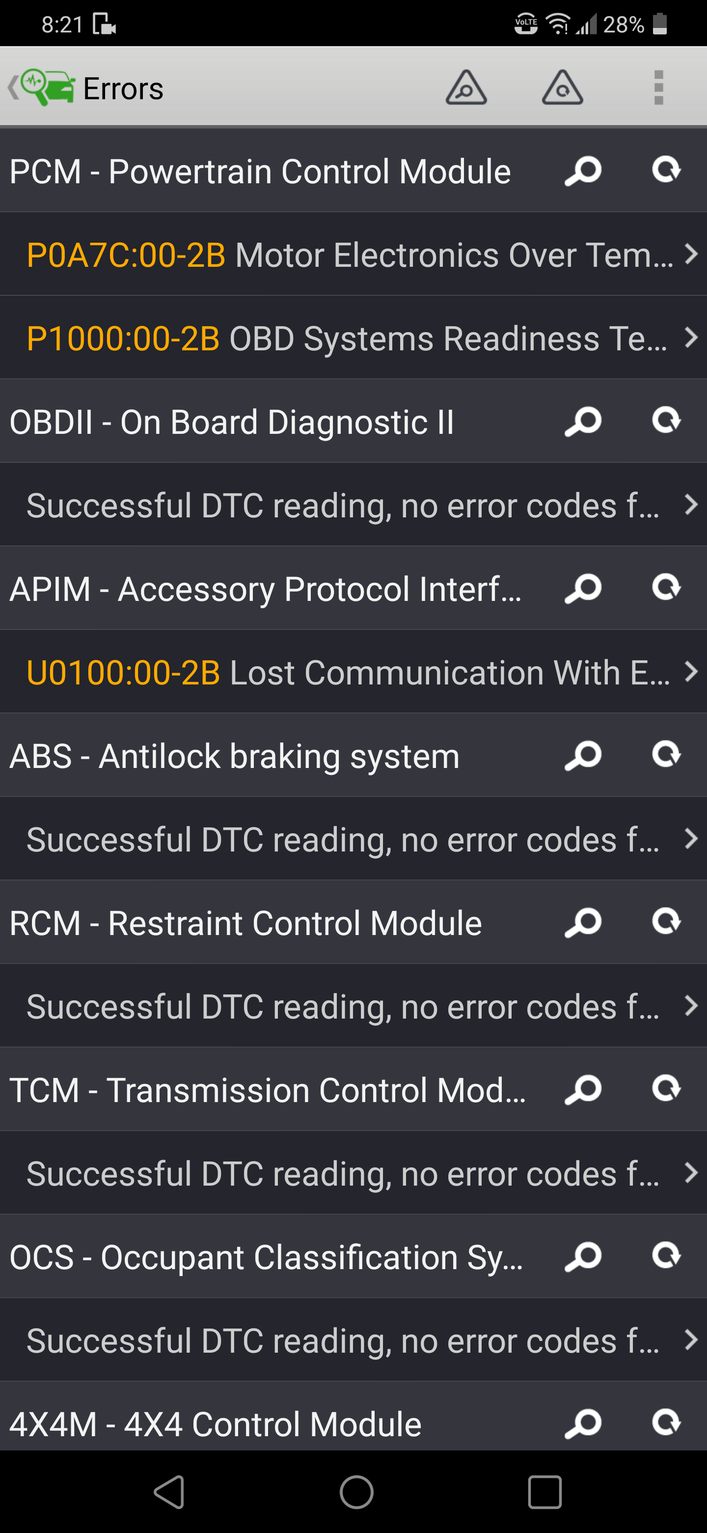

Jasonisawesome, which code exactly are you getting with your Escape?

Re: P0A7C criteria PCM parameter / wrench light?
P0A7C:00-2Bwr400f250 wrote: Thu Jan 14, 2021 4:13 am Jasonisawesome, which code exactly are you getting with your Escape?
- Screenshot_20210113-202140.png (425.31 KiB) Viewed 3513 times
