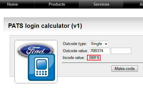

This website seems to work: https://www.fordradio.codes/pats/
I tried the 70B374 Outcode above abd the website returned the BBF8 Incode.

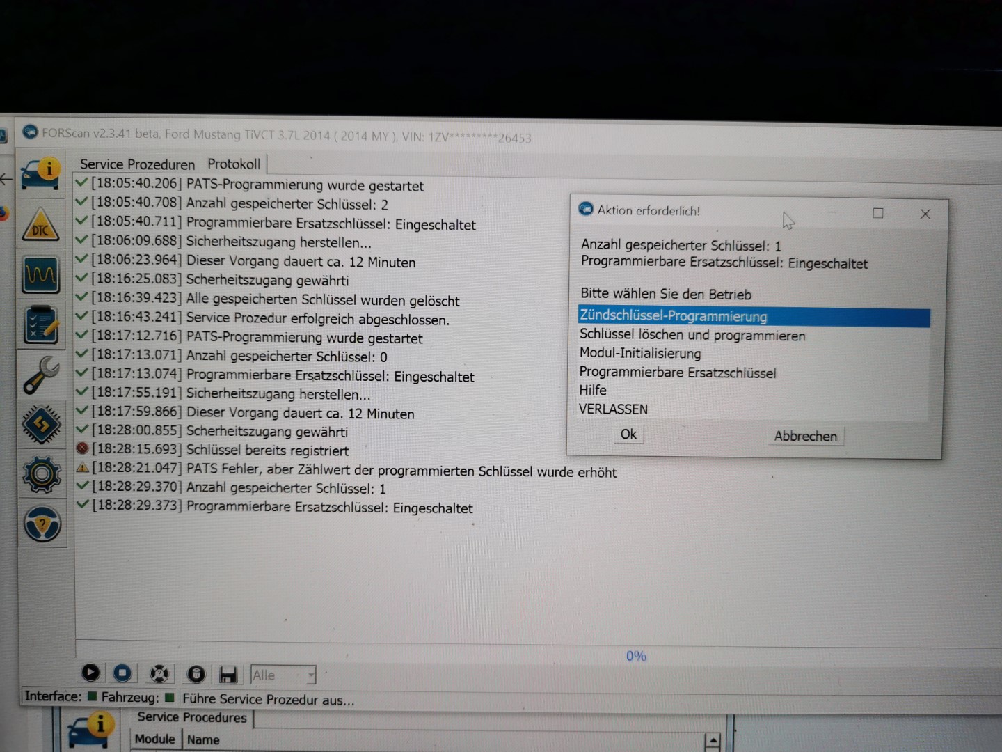

hello,
my original, former problem was: I wanted to start my 2014 Mustang, but accidently pressed this f***n panic button.
Then this key was "damned" with the theft symbol in the dashboard.
Now I wanted to reprogram this key as regular key and followed the ForeScan instructions.
But - this may be the reason for the problems: I lost twice the connection while waiting the 12 minutes due to a problem with the "IDS" communication software. So this process interrupted.
After reinstalling the communication software ForScan worked well, I could erase the two keys and started the
"Ignition Key Programming option" process.
but then - with the master key, these messages came up:
"key already registered"
"PATS error, but counter of programmable keys was raised"
count of stored keys: 1
Now both keys show the theft symbol in the dashboard...........
What can I do now ?????
Thanks for any help.
