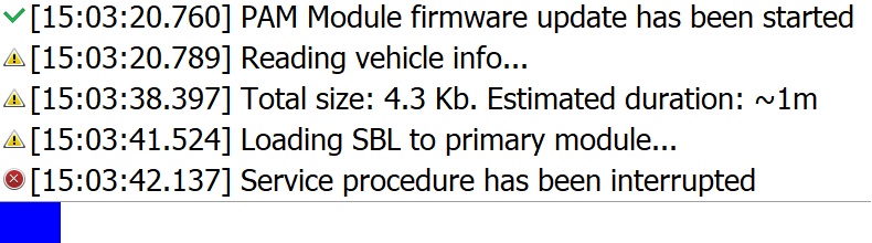

I have a 2012 Focus MkIII Titanium. I am running FORScan 2.4.3 with an ODBLink EX.
While trying to upgrade the firmware on the PAM module, when I attempt to "Test Run SBL", it fails at 2%, simply saying "Service procedure has been interrupted".
I have tried resetting the PAM module, but it did not help.
"Test Run SBL" is successful on other modules.
Any suggestions?

You may have just found the reason that there is an SBL test button. Usually when this question has been asked elsewhere on the forum, FORScan usually responds with words such as, "There is no way to predict what Modules a Service Procedure can be run with so it is included for all and that error message will throw when a module is encountered that does not have the provision to run that procedure built in".
That particular Module my not be Secondary Boot loadable and there for it could be Firmware Fixed and not up-gradable! A good question would be , Why are you running these procedures as this is not a service that should be run "Just because I can"! It should only be done if there is a Ford Service Advisory that requires updating Firmware in a module to fix a problem! This is the most risky procedure ever done on a vehicle. This has been known to "brick" modules and Vehicles even in a Dealer setting with Dealer equipment!
If this as any consolation I have PAM modules in two vehicles(2003 Expedition and 2010 Fusion) that this message throws if i try to run any service procedure and the only configuration that can be done is on the Fusion and it is only two digits(0 and 1) on the 736-01-01 address, one for body style(Set to Four door in this case) and number of channels( this one is set to unknown vehicle value). The Expy is not even configurable and throws that error on any procedure I run, including Configuration and AsBuilt, and both Forscan and IDS ask whether it is 2 Sensor or 4 sensor(this one has Four) when it is first connected as apparently it matters to what they read initially!
As you asked for suggestions that is all I have! If you hold a Paid license you can roll your Log and dump.bin file into a .zip file and send to https://forscan.org/contactus.html as per instructions at this page https://forscan.org/contactus.html and see what they say about it!

I have ordered a Sync 2 -> Sync 3 upgrade. From what I've read, once the APIM is replaced, there is a good chance that the parking assist, backup camera etc. may not function correctly, and that upgrading the PAM firmware should fix it. I was planning to be prepared, and upgrade the firmware while I wait for shipping.
I do have a paid license (1 year), and I will see what the team has to say. It sounds like I may be better off trying to source a newer PAM module and replace it. I guess I should wait until the Sync upgrade is complete, and see what is what before I take any further action :D
Thanks for your help!

FYI, I did send my debug info to the FORScan support team. They provided me with a test build, and it resolved the issue. I was able to successfully update the PAM firmware.
Wonderful support!
