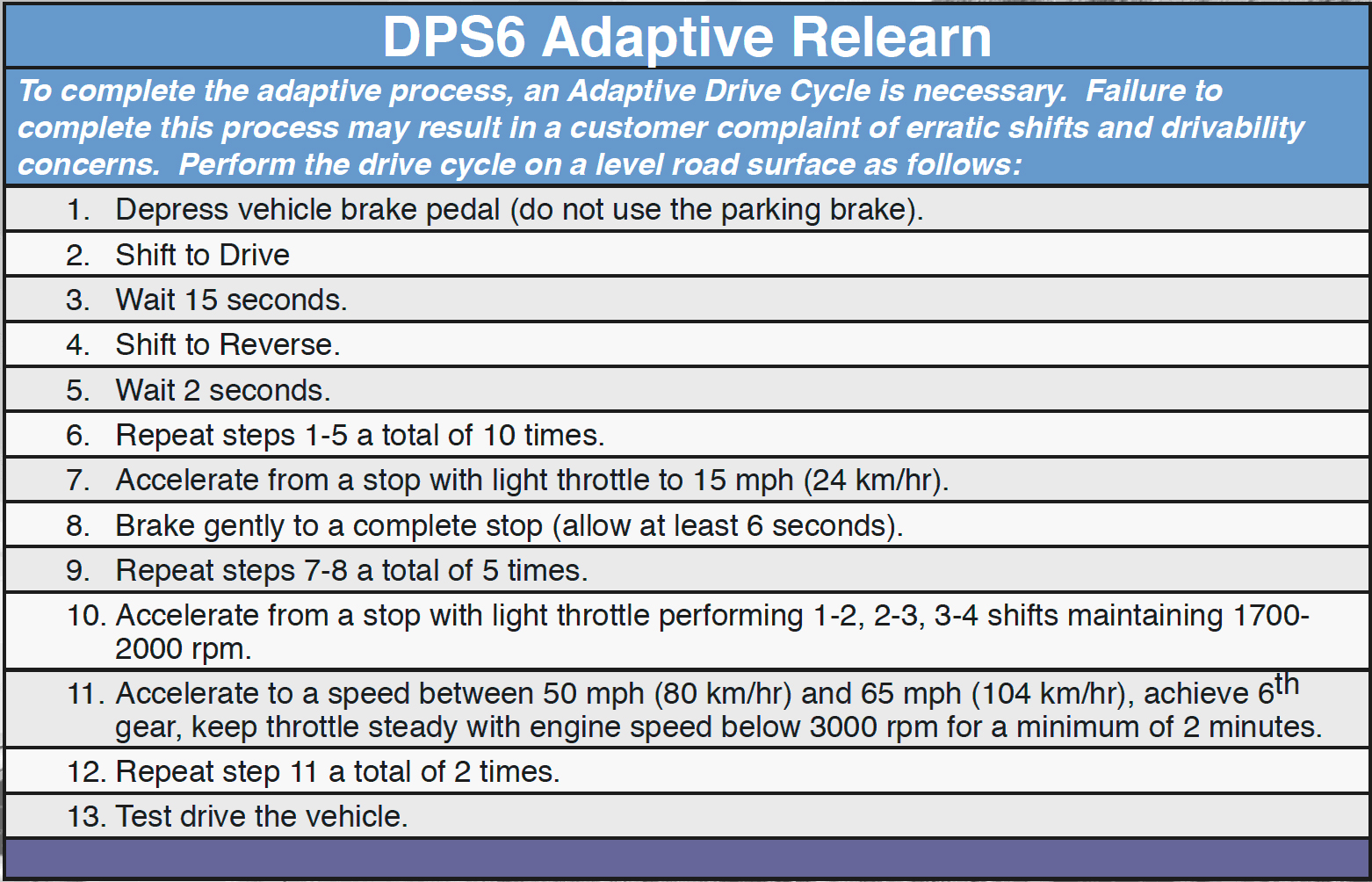

@ yuvalf
Read this setup table and document.
"I think if you do the Adaptive learning procedure while the car is on a charger it won't work right. Try the procedure with the battery charged but not on the charger. If you update the Module then try to keep it on the charger while updating."
You completely misunderstood what was written. Any Ford transmission that is rebuilt or repaired gets an automatic flash update.
The power supply keeps the model alive. A power supply creates little to NO AC ripple.
The battery charger is no different than a cheap welding machine.
AC ripple from cheap welding machines creates a disaster on the network.
The test also includes the alternator to test for AC ripple.
AC ripple from the alternator is no different than a cheap welding machine.
The adaptation is NOT done with the power supply on the battery.
@ yuvalf
