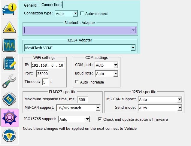

f-wolf wrote: Wed Feb 14, 2018 11:43 pm
Hawkeye3006 wrote:When I try to download the extended license I get a message that says "Windows can not open this file". then wants to direct me to the internet for help. Anyone have a suggestion?
I use WIN XP on my my Laptop. NO problems with Extended License...
But I see some people got problems with WIN 10 ...
I installed Forscan on my PC running WIN 10...and yes there is a Problem with actuating the extended license...
This is what I did...
Download the extended license...make a new folder and name it License. Put the extended license .key file in to that folder.
Go to Windows (C:) and find the FORScan Folder... Mine was in Program Files (x86)
Paste the " License Folder " in to FORscan...
Or: Right click on ForScan shortcut, Properties, Open File location...put License Folder in there.
Next:
Open the FORscan program
Click on [ Load License Key ] and this should take you here ...
Open License Folder and take it from there...
When done it should look like this:
Hope it works for you as well !!
