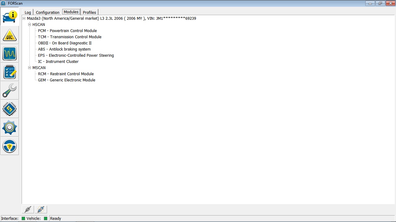

For some added information on J2534.
This time with the new updated version 2.3.6 beta:
Working perfect is the CarDaq Plus and the CarDaq Plus 2.
This time both the HS and MS networks are in view with both CarDaq tools.
The connection is very fast and the data refresh is much faster than the ELM that I still currently use.
FORScan staff - very well done and many times I still prefer this version over the Mazda IDS.
This test was on a 2006 Mazda 3 North American vehicle

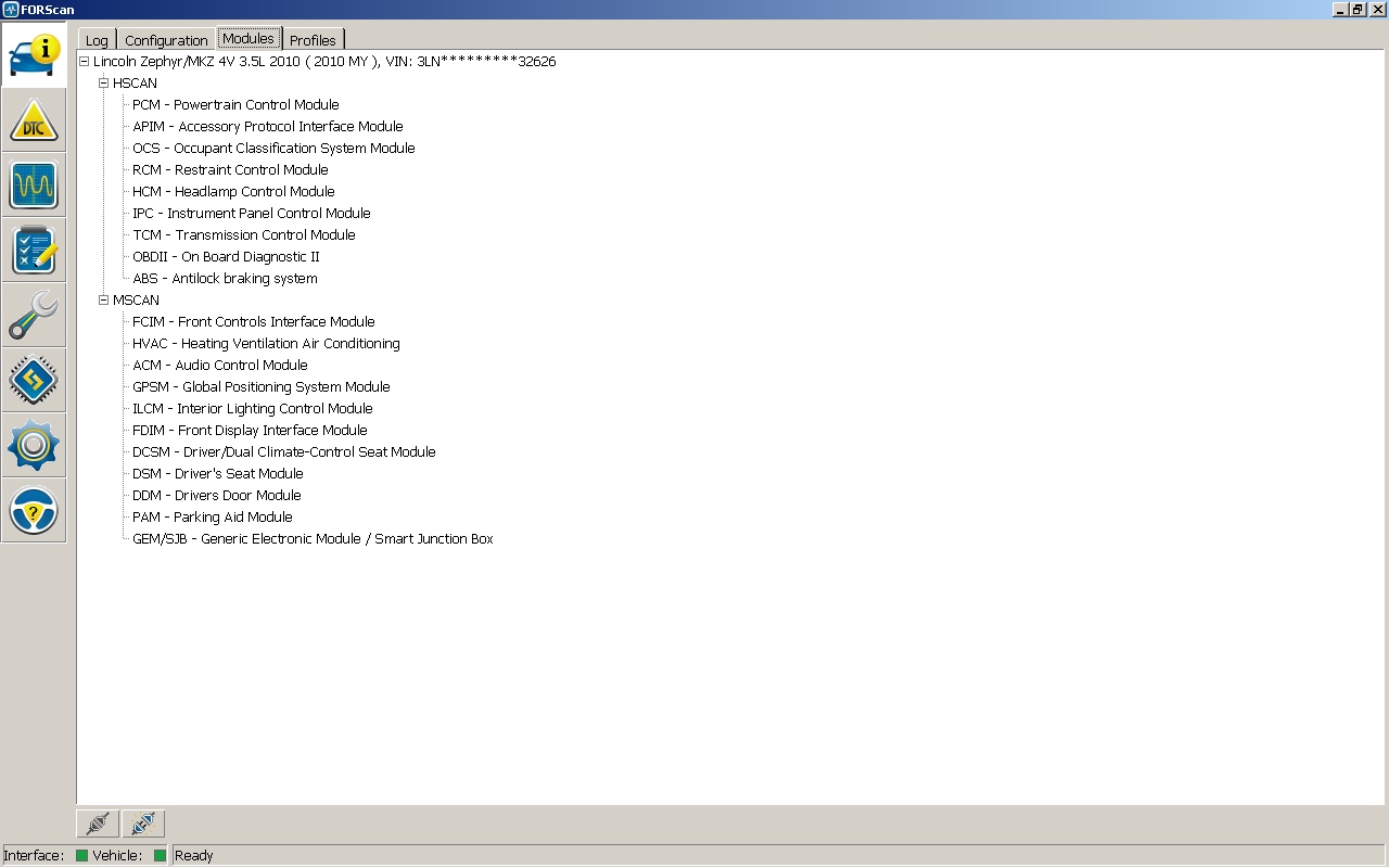

2010 Lincoln MKZ North American version
This is another success with Forscan and the CarDaq products.
Great work Forscan staff.
