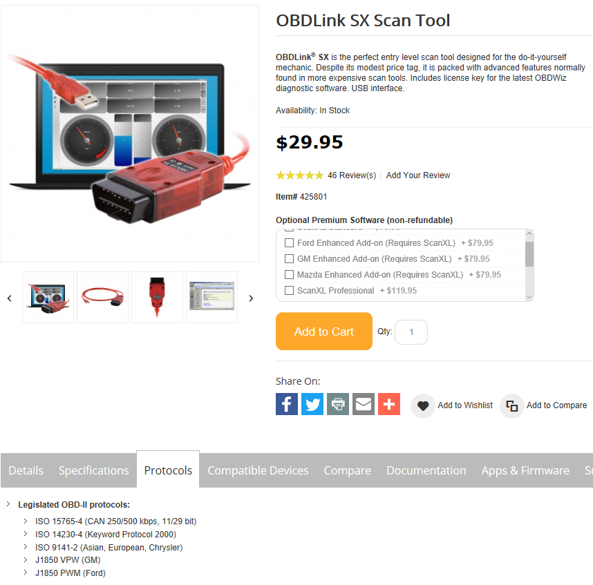

Hello, I am new here and i am looking for a adapter. I have read this whole thread and have seen a lot of good things about scantool.net but a have seen nothing on the odblink sx adapter can someone please tell me it this is a good adapter. Im looking for something that will do all forscan has to offer. I need keys reprogrammed. Also im fighting a lot of gremlins in my daily driver so any help would be helpfull. this is the web link to it https://www.scantool.net/obdlink-sx/

I have this adapter and I have the same year F150 that you have. This adapter is limited to OBD, ISO/SCP and HSCan protocols on these older Fords as there is no MSCAN on these trucks and the OBD SX Adapter has no MSCan Ability natively and is difficult to do the switch mod without doing it in the cable or in a separate OBD extension cable.Their are Forum members who have done this but I have not as I opted for a VCM2 Adapter for the reasons I outline below!mrgoodmccann wrote:Hello, I am new here and i am looking for a adapter. I have read this whole thread and have seen a lot of good things about scantool.net but a have seen nothing on the odblink sx adapter can someone please tell me it this is a good adapter. Im looking for something that will do all forscan has to offer. I need keys reprogrammed. Also im fighting a lot of gremlins in my daily driver so any help would be helpfull. this is the web link to it https://www.scantool.net/obdlink-sx/
It would not help with these older Fords anyway as these older Fords use a single line Uart based(UBP) protocol on pin 3 (The + MSCAN pin and the main reason for the UBP problem in Forscan) in the OBD connector and development for it in ELM327 based adapters has proven to be difficult if not impossible. The Forscan team has informed me that they are still still looking for a solution to the problem but for now the only option for these vehicles is Ford VCMII, SP177C and C1 china VCM2 Clones and some J2534 Passtrhru Adapters such as CANTIECAR.
I also have a China Clone SP177-C VCM2 and it does work very well in HSCAN/MSCAN in Forscan for newer vehicles( I also have 2010 Fusion) (uses the latest Bosch VCI Manager as the driver interface) but Forscan does not support UBP For The VCM2 and other J2534 Passthru adapters unless one is willing to be a beta tester for them. The UBP protocol is an obsolete North American Ford protocol only and the Forscan team has little access to vehicles to test it with.
Cantiecar is said to work with their software but the only other option with VCM2 adapters is Ford IDS and that is difficult to to get working without spending a lot of time researching patches or VMWare Solutions on various automotive forums, most of which require a monetary donation to get a login and which only work if you are willing to do some hacking yourself, unless you are willing to pay for Fords very expensive license.
I have a couple of setups that work but I will not bring them up here as that would violate Forscan Forum rules!
Unfortunately with automotive diagnostic adapters you very much get what you pay for!
