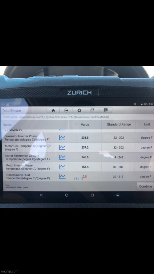

Re: P0A7C criteria PCM parameter / wrench light?
On highway temps
Generator Inverter Phase 232F
Motor coil temp 238F
Motor Electronics Coolant 144 F
Motor Inverter Phase 155F
Transmission Fluid Temp. 221F
The trans temp was red on my scanner and while I was driving aggressively on the highway trying to get it to give me the wrench light and cut out I finally chickened out and drove home. I don’t want to get stranded for the third time. I have had to tow this car now twice.
I didn’t take a pic of the temps on the driveway but I was monitoring them while I was spraying water on the mecs radiator and I could get as much as a 30 degree swing in temp difference.
I placed a digital thermometer on the gas bottle and I could see a 30 degree difference between the scanner temp and the gas bottle temp. Scanner would show 110 degrees for coolant temp and the thermometer would show 144F.
I put a stethoscope on the mecs pump and I hear it running but my thought is since it’s able to cool down while spraying water rather well, I’m thinking it has something to do with volume delivery. Maybe the pump is not moving enough coolant to dissipate the heat fast enough.
Tomorrow I’m taking the system apart and bleeding and backflushing the system. I’m hoping for a clogged radiator or weak pump.
Will keep you posted
Continental_man
- Posts: 7
- Joined: Sat Jun 26, 2021 10:18 pm
- Vehicle: 2010 Ford Fusion Hybrid Atkinson engine
I finally figured out how to resize the image. This is the temp while I was driving on the highway

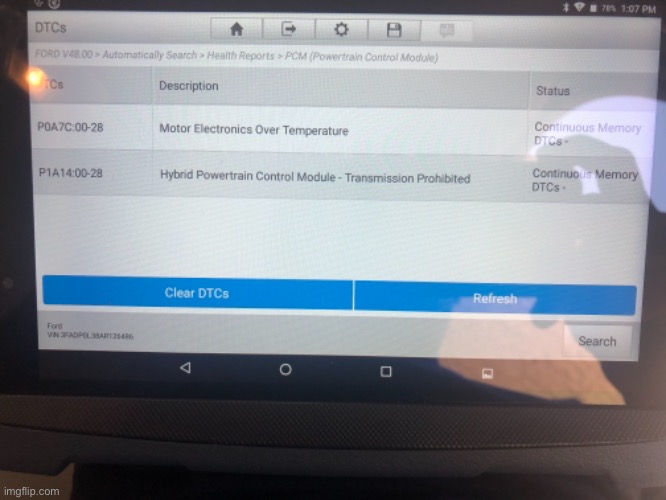

Here is one set of codes I get
- 7D8C8EE2-9B40-4CCC-A4A5-93DFE8022B4A.jpeg (61.42 KiB) Viewed 2781 times
