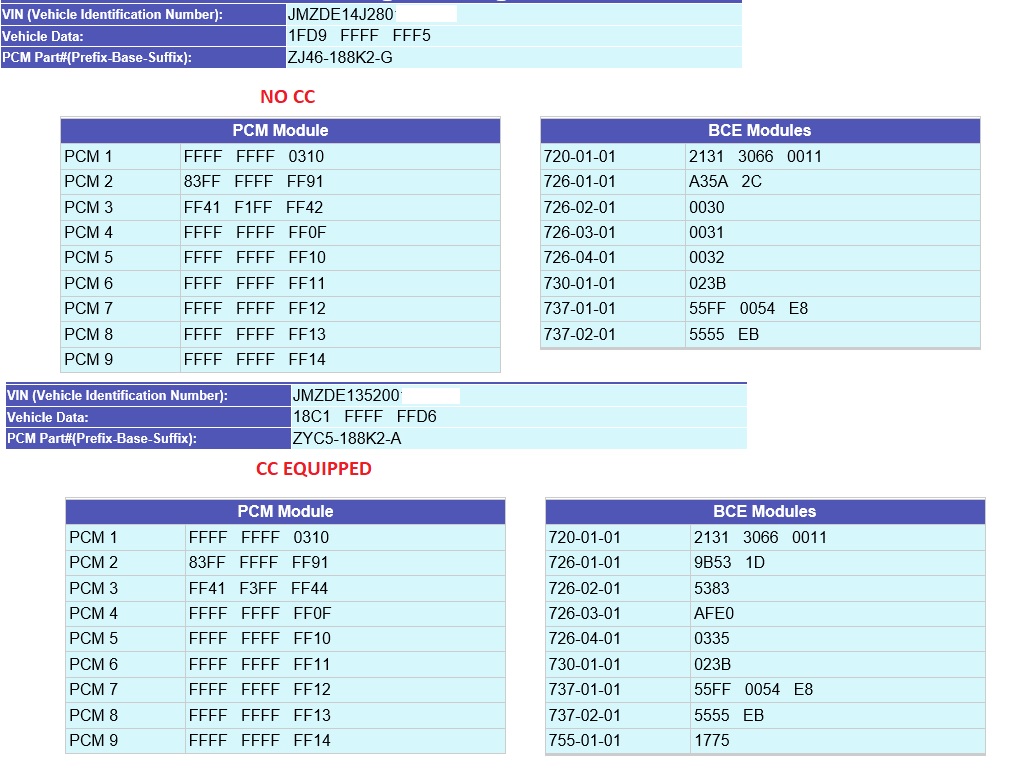

I have a Mazda2 DE and fitted the steering wheel with CC. Still waiting for the brake switch. I'm on the same boat.
My PCM3 Line is the only difference like the BL mazda3. The CCC data have a minor difference in first bytes.
- cc.png (4.14 KiB) Viewed 9504 times
- pcm.jpg (209.04 KiB) Viewed 9504 times

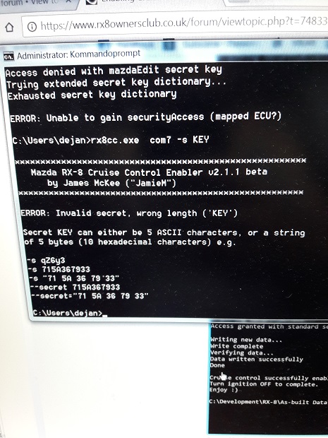

i followed jamies descriptions about enabling cc on rx8 and i have used jamies both programs. awsome work you have done jamie. thanks.
everything works fine, i can get into pcm and read as built in data and even download it on my pc.
however, i am having issue with security code key. i cant get pass that to enable cc.
it seems that the security code is changed. any advice on this issue?
- are these codes?
- 20180523_210349.jpg (156.62 KiB) Viewed 8874 times

I'm afraid if your security key isn't one of the ones known to rx8cc, which tries all the keys from Mazda's IDS software + the one I know of for MazdaEdit, then there's nothing we can really do (not via OBDII anyway), unless you know what the key is. Is this an RX-8 I asssume? I have never seen an RX-8 that doesn't have either Mazda's standard key or MazdaEdit's, so this is strange, unless MazdaEdit have found out about my project and changed their key in response
Has your ECU been mapped?
The only way to obtain an unknown key is the way I originally did it for mine - dump the entire ROM via the AUD port of the microprocessor on the circuit board (see https://www.rx8ownersclub.co.uk/forum/v ... 0#p1015427) and compare it to a known map e.g. stock to find the address of the key. This requires soldering to the ecu circuit board (https://www.rx8ownersclub.co.uk/forum/v ... 5#p1017363), and building some custom hardware to talk to the cpu (or buying Renesas's expensive debug hardware... I built my own: https://www.rx8ownersclub.co.uk/forum/v ... 0#p1024384) - not something I'd recommend unless you are really comfortable with that kind of stuff.

thanks for your reply jamie. i did tuned my ecu once with mazda maniac coobport. but after rebuild i got installed stock software.
mm wrote that ecu could be locked if not changed to stock software,probably reason my issue. i bought another used ecu and was able to enable cc with rx8cc.
but, cant start the car even numbers on ecu are same.
