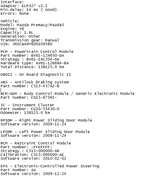

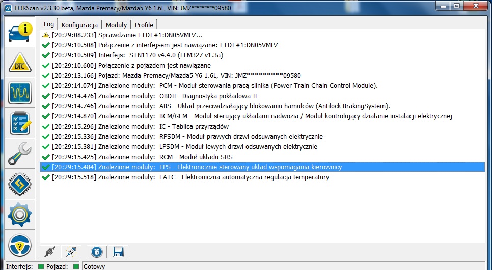

patryczak
Joined: Thu Apr 09, 2020 11:29 am
Vehicle: Mazda 5 CW 2010 1.6 CITD/TDCI
Re: Ford Focus MK3 "reset all adaptation" function
Post by patryczak »
Hello everyone,
My first post here.
1st of all - FORScan developers thank you for such a great software.
I am driving Mazda 5 CW 2010 1.6 CITD/TDCI 115HP(same engine as FORD MK3 or Volvo 1.6D).
I use Vgate-Icar2 bluetooth or STN1170 for connection with Forscan (2.3.30)
I have a question about the visible PID's in FORScan.
FORD users can see the PID's such as: INJ_LRN_C1 or CYL_BAL or any connected with injectors (i.e. correction values).
For my car is not visible in FORScan. None of them.
I attach below visible MODULES in my car and also configuration details.
Using STN1170 (with MSCAN) vs. ICAR VGATE2 the difference is only EATC MODULE - with STN1170.
Could you please advice if the issue is connected with FORScan version, OBDII(drivers) or the PCM doesn't show these PID's to program?
