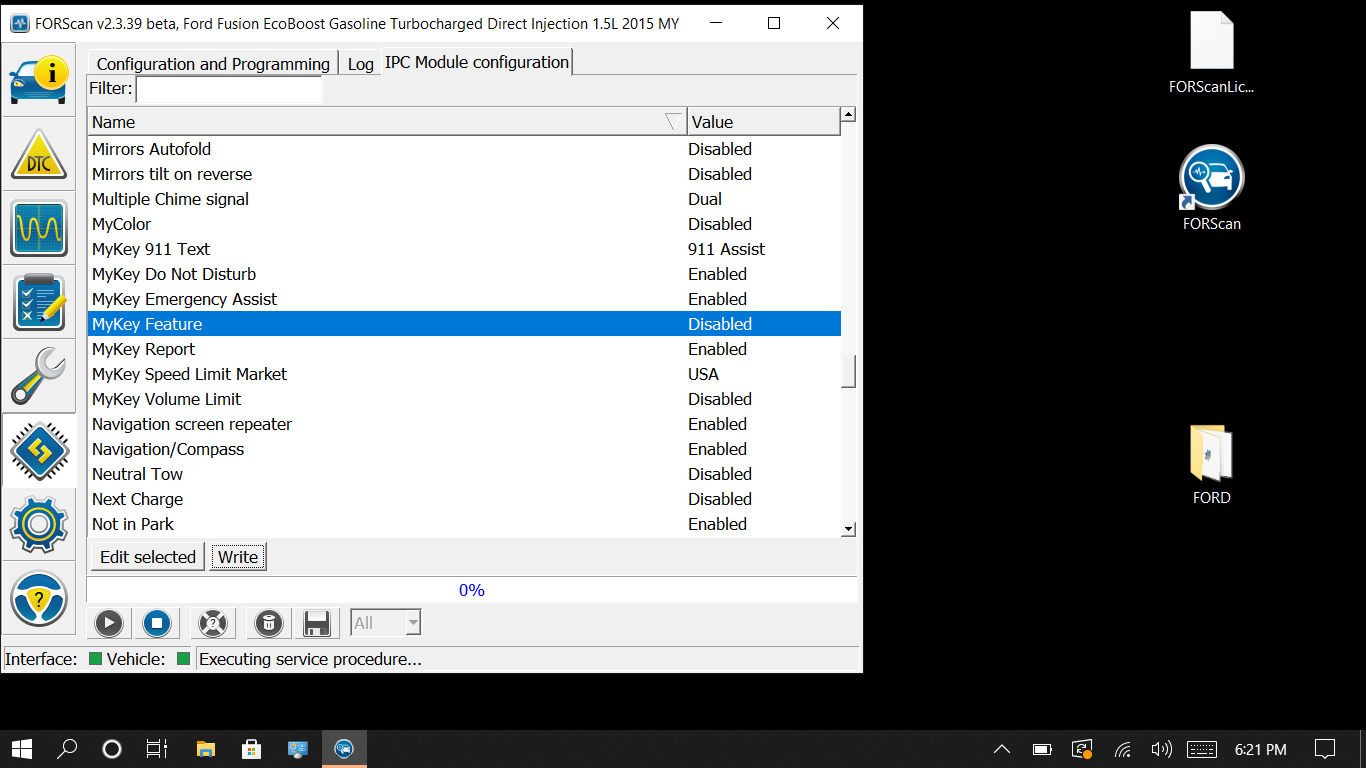

dalekrebs
Joined: Wed Aug 22, 2018 7:12 pm
Vehicle: F150, V6 3.5L twin turbo, 2014
Re: How to clear MyKey without admin key and programming
Post by dalekrebs »
reprogrammed my daughters 2015 Ford Fusion mykey settings.
Could not use the FoCCCus application...it would not read BCM/ECU modules.
In FORScan, I used the IPC module configuration (NOT THE -As Built Format)
sorted based on feature name and MYKEY multiple settings are listed.
MyKey was set to enable...changed to disable and wrote to module.
followed onscreen directions...result, MyKey limitation were removed.
Finnjani
Joined: Fri Jan 27, 2017 4:03 pm
Vehicle: Ford Mondeo 2.0 TDCI 115Hp year 2003
Post by Finnjani »
dalekrebs wrote: Sat Mar 27, 2021 11:42 pm reprogrammed my daughters 2015 Ford Fusion mykey settings.
This worked for my B-max 2015 1.0 Ecoboost. Thx 😊
