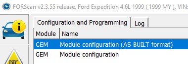

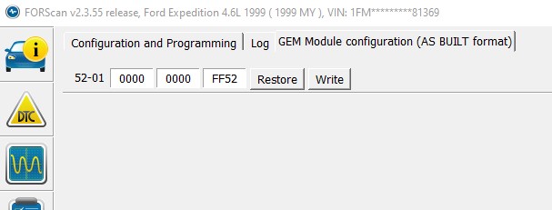

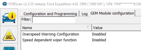

I'm trying to update the axle ratio and tire size on my 1999 2WD Expedition so I can correct my speedometer. I cannot figure out how to do this with my Forscan for Windows Extended License.
I have searched the Forscan Forum, FTE, and the ExpeditionForum.com and have not found anything close to my vehicle.
I can view PIDs to display the axle and tiresize from the PCM but under Configuration and Programing it only gives me 2 GEM options, no PCM.
Is this impossible with my vehicle and Forscan or am I missing something?

The PCM adaptions / programming features need to be investigated but quite certain that model is too old and may not have the adaptations / abilities / changes within the engine management system.
If it is possible, the PCM would need to be programmed with those chages (providing the changes are supported).
The Hypertech Speedometer Calibrator reprograms the BCM (Body Control Module), not the PCM (Powertrain Control Module). The Hypertech device is used to maintain speedometer accuracy.
