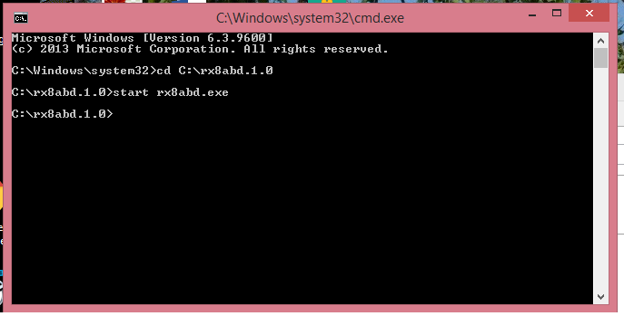

I did the command prompt method and it was still closing automatically. I even tried adapt adding /K at the end to keep the window open, no joy

after i get that far the application launches in a new window and closes instantly. i very quickly see the first few lines of text and then it closes

don't type "start"
Just type the name of the program directly without "start" in front of it, as per the link I shared.
Actually, for your first run of the program I'd recommend typing the following:
Code: Select all
rx8abd.exe --help
so that you can learn the different options available :) Exactly like that. No "start".
(I'd also perhaps recommend reading up a little on console applications and running them from the command line ;) )
"start" is for running graphical applications, not console applications like rx8abd ;) :D

Got it to run. Had it running in xp compatibility mode for some reason. Thanks
