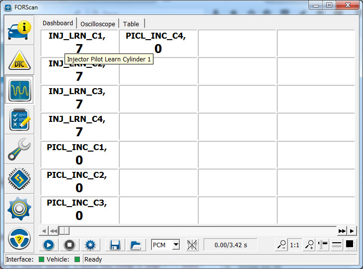

i have the same car and i changed the 4 injectors.
You need to add this conf to forscan see the injector learn :
Go to the road and :
1.3rd 4th 5th or 6 gear
2.Over 40 km/h
3.Deceleration repeatedly from 2500rpm to 1500rpm for 20 km (we ended sooner)
Normally : inj_lrn_c3 must move to 7
For the moment, i cannot test this procedure because i have a DPF error.
I wash it and now normally it's okay.
I will test this procédure tonight :)

flyb87 wrote: Mon Nov 30, 2020 3:14 pm Hi Extrema,
You need to add this conf to forscan see the injector learn : FF3_1.6_TDCi_inj_learning.jpg
2.Over 40 km/h
how do i get in forscan to this screen you pictured where can i see which injector works how much? which menu should I choose, and should the car be turned on?

what version of forscan is needed for this display? i have v2.3.37 ...
