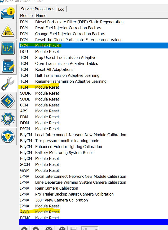

Making it quick - 2023 F350 6.7L HO Lifted and new tires and rims from stock to 37 X 13.5 x R22.
Speedo is off +8Km/h actual or (108) at 100Km/h indicated on dash
I did spend the time to READ the @zoodad (Rock star) threads and have tried to walk my way through the process however I keep getting the wrench and engine light when I change the Tire Circumference in the BDY module (English).
Original setting from factory = 2631
I looked to find the setting for my tire size and have tried 2941 but then realized many people are saying that is way too high, so I went to others who tried 2770, 2780.
I do the PCM TCM reset and clear DTC codes and still get Wrench etc.
Being a very JR user, get a bit scared to mess something up I put back to 2631, do the PCM TCM RESET (as there is no RELEARN) and Clear DTC's and it is fine.
I do not have "RELEARN" only RESET for PCM TCM - see attached. I have tried 2746,2770,2780,2799,2800. I'm positive there is a step I am missing,
Is there a number that has worked for similar and maybe 2023 is different? - @willyfly4food - did you change any other settings or just the tire circumference in the Bdy CM ?
Happy to take suggestions or advice from someone with same settings on same year?
Thanks!
