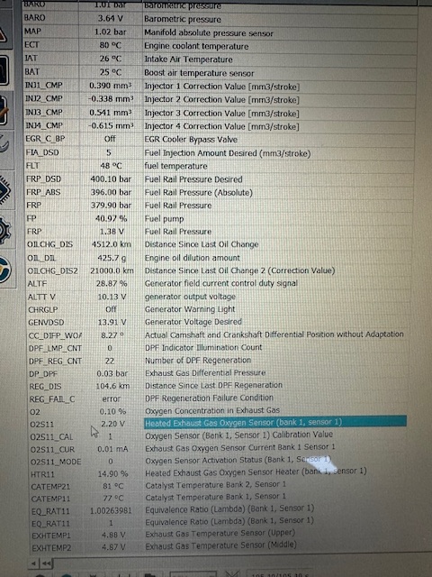

I was wondering what is normal value for the O2 PID.
At idle and when the engine oil temp is 50°C, I have around 11.0 to 12.5 %.
I was searching and did not find what is correct value... :roll:
Car: Mazda cx-5 AWD 175 hp 2.2 Diesel with 137k km
Screenshot_20220514-125059_FORScan Lite.jpg (802.67 KiB) Viewed 2859 times

Update: I was asking this after poping out the P0154 error, especially when the engine is hot (÷85° C) and then decelerating, like going down from a hill.
Today I went to a friend workshop, he adviced me to by the Denso lambda sensor (130 euro).
Also he tried to clean it with some carbon cleaner and pressured air, and after install it back, I drove home and the error did not show.
When the news sensor arrives, I will install it.
Please note that after cleaning the sensor, the O2 % increased and it seems that the value of HO2S11 (in mA) is more variable, as for example I was able to see - 0.85 mA wrt before when quite all the values were possivile and above 0.50 mA.
Not sure about the impedance that stabilizes at 28 Ohm (at engine start it's around 400 Ohm).
The comment of my mechanic friend was: it's normal to change this sensor after 137k km...

Wideband oxygen sensors should usually last at least 160,000 km's. But it is not unheard of to see a failed wideband at 16,000 MILES in my experience although rare. Bear in mind an oxygen sensor senses oxygen so if its rather dirty it can read incorrectly. Also wide band and narrow band work differently so how you read the data is different voltage (narrow band) vs current (wide band). A new lambda could well cure it.
