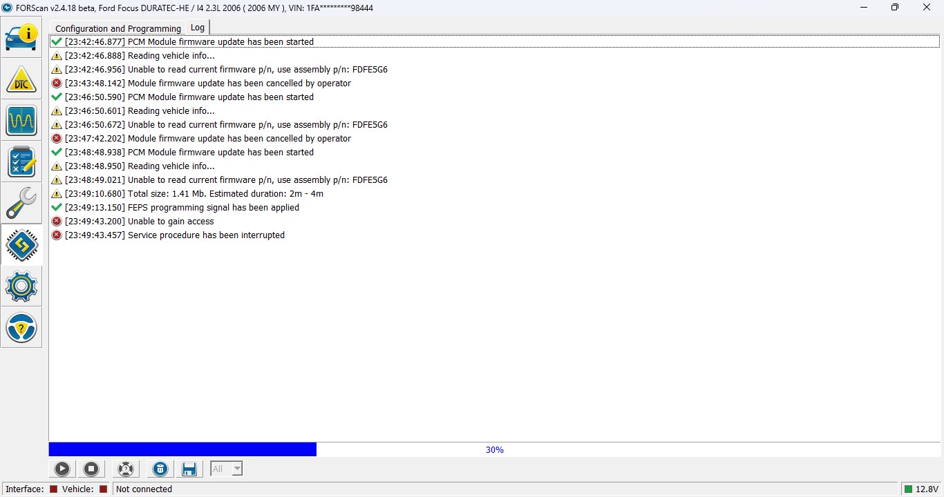

Trying to update PCM on 06 focus ECU, and I keep getting these errors. I went through the guide and updated settings etc. w/ no change.
Windows 11, w/ OBDLink EX w/ current drivers, FTDI drivers etc.
I also have VCM 3 drivers on here for the VNCI clone if that makes a difference somehow.
Thanks!

Nvm I figured it out. OBDLink EX doesn't support FEPS. Gotta get vLinker FS
