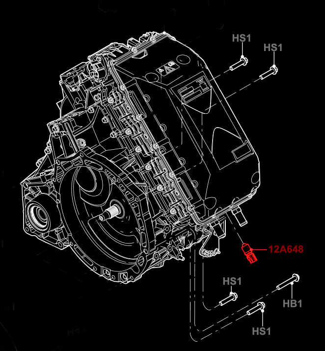

So I'm now having this issue with a 2012 Escape hybrid and have;
• Changed the MECS pump
• Vacuum filled the MECS loop ($213 at the dealer....next time I'm just buying the vacuum filler set)
But the wrench light (reading P0A7C:00-28 via FORScan) continues to be reliably summoned by climbing any hill that keeps the engine RPM near 3k for any length of time. I'm leaning toward swapping the temp sensor below as it's only $30ish but getting TO it seems to be tricky....I'd like to inspect the connector at least.
Has anyone gotten any farther with this? I'm supposed to have have driven a couple states north by now and have a '4WD' cuv that can't climb any hills. Dealers can't even make an appt within 2 weeks and based on the rest of this thread I kind figure i'm on my own

Re: P0A7C criteria PCM parameter / wrench light?
- Screen Shot 2021-08-30 at 11.13.39 AM.png (217.65 KiB) Viewed 2248 times
