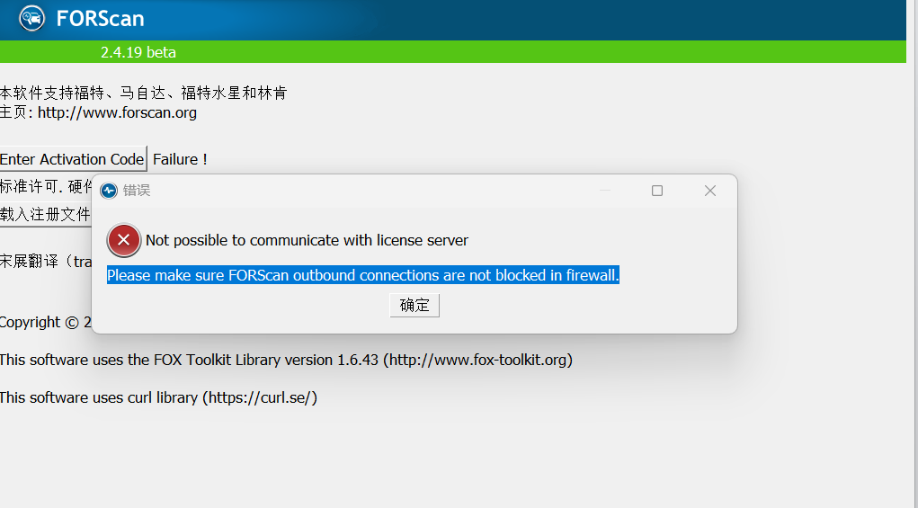

The license cannot be registered, and it shows that it cannot connect to the FORS server. I have turned off all the firewalls in my computer settings, but it still doesn't work. I am in China, please help, thank you!
