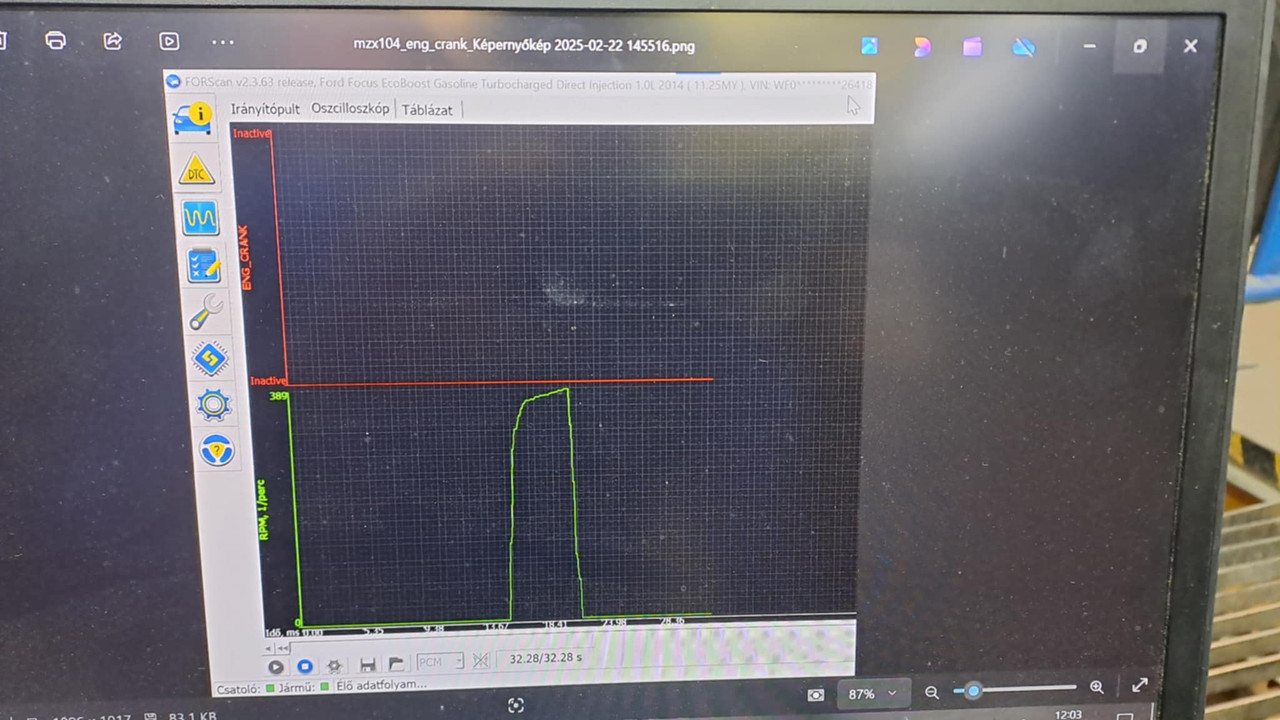

I need some help. There is no error code, the engine cranks but doesn’t start. The timing is in place, and the crankshaft signal is good. What I noticed is that ENG_CRANK remains inactive while cranking. Has anyone encountered this issue before? Does anyone know what activates the ENG_CRANK bit?
It's not visible in the image, but there is another bit, KEY_START, which switches when cranking.

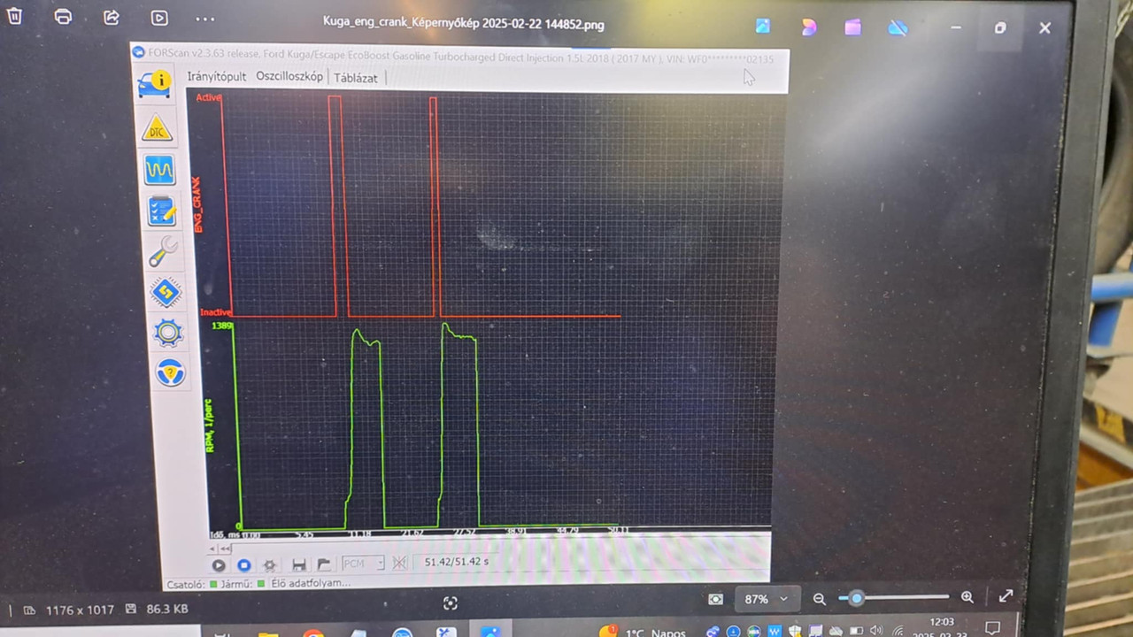

I checked on another car, and there, it switches to active immediately when cranking:
