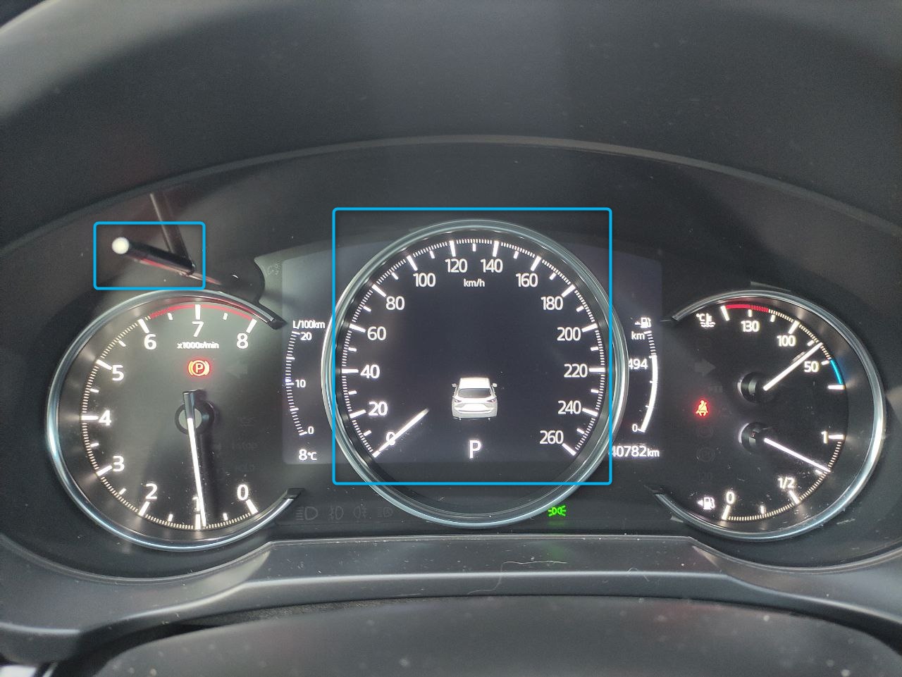

Hi Everyone, do anyone possibly know where is an option to change the selector knob and to enable/disable digital speedometer from km/h to mph and back in the IC module configuration?
