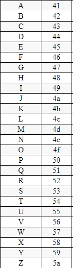

Hi: I know country code as follows:
US 5553
CA 4341
AS 4153
VI 5649
UK 554B
MX 4D58
UM 554D
ES 4553
RU 5255
PL 504C
IE 4945
DE 4445
BR 4252
CN 434E
MI 4D49
GA 5753 (includes navigation input while driving)
It can be changed in API:
7D0-02-01 0455 5300 0086 (MODULES with SYNC 1.1)

from which land is this code 4452?
This is in a Mustang from US, but the language is from NL, Nederlands..., Its wrong :D
edit: I found it for my self :D
