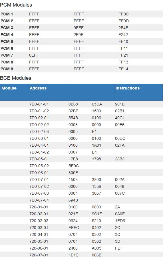

And this is sync 3 file
SYNC 3.png (24.68 KiB) Viewed 5890 times

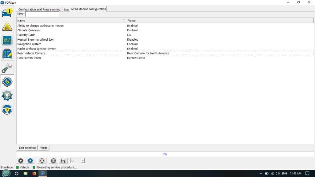

lenko
Posts: 698
Vehicle: 2015 Lincoln MKC(Sold), 2006 Mustang GT, Saleen 530 HP
Re: ADD CLIMATE
Post by lenko »
May be an easier way for climate. Enable it on this page:
