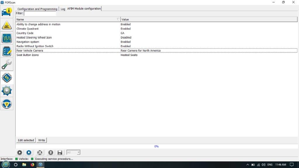

In the latest Forscan there's a setting in either BCM or IPC where you can just turn it on.

Here is the setting. The very top one: download/file.php?mode=view&id=3875

Hello,
I mean the video restrictions for av input, to connect a dvb-t receiver while the vehicle is in motion. Not the settings for the rear camera.

Is the pichture only with the newest version og forscan

APIM 7D0-02-01 x7xx xxxx xxzz
Fusion 2013 Sync2 Touch work.
