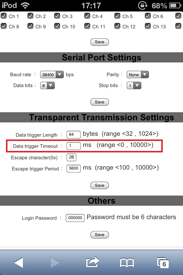

We have found out that the problem is in a default TCP-serial timeout setting. Here is how to fix it:
  1. Connect ELM327 WiFi adapter to OBDII jack of the vehicle, wait for several seconds until the adapter is loaded
  2. Connect your computer or other device to the adapter over WiFi.
  3. Open Web browser and type address of your adapter to the address string of the browser with ‘http’ prefix, for example:
    http://192.168.0.10
  4. Enter login ‘admin’ and password ‘admin’. Note: login and password may be different. If admin/admin doesn’t work, contact your seller for the actual password.
    As a result, you should see something like this (source of our problem is marked in red):
  5. Change the value from 100 to 1 (not 0!) and click apply.
  6. Make sure the change is applied (after adapter reboot)

We get complaints from users that the standard admin/admin access doesn't work for some of adapters that look like this:
Important finding of Grzegorz Milaszkiewicz: right password for such adapters is '000000', so right credentials are admin/000000.
Addition from Maciej Duda: In settings ELM set data triger timeout not 1 ms but 10 ms. When I set up 1 (Min. delay in ForScan was 200 ms)
but when I set up 10 (Min delay in ForScan was 30 ms)

Re: Performance fix of china ELM327 WiFi adapter
Here is screenshot from Grzegorz, it shows what to change in admin panel in order to reduce the delay:
