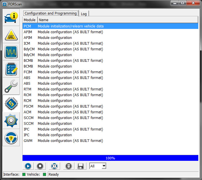

Re: P160A code after tire size change??
P061A code
*** The latest version of Forscan has a PCM Relearn and a TCM Relearn feature that clears the wrench icon after doing a tire size change. ... changed the tire size ...and got the wrench icon and initially couldn't clear the code. ...selected the PCM Relearn and the TCM Relearn options, the DTC code and wrench icon were cleared. Took the truck out for a test drive and all is good.
I need some help. Do I need to tune to stock before I do this relearn? I have the po160 code after changing tire size on my 2015 SHO.
Please help. I can't get rid of the wrench after changing BCM 726-12-01 to 09E7 (was 09AC). Speedo is right on the money though. I have researched all the forums, run the Module Initialization/Relearn function several times, tried to delete the TCM DTC P160A multiple times. No other DTCs exist. This is a very persistent wrench.
Casting necromancy on this thread.
Did you ever find a way to clear the TCM version of the P160A?
I don’t have a TCM relearn, and can’t get that DTC to clear!
support_team
- Posts: 289
- Joined: Wed Feb 08, 2023 6:53 am
- Vehicle: Support and moderation team
Please address your problem to the support team and provide VIN, we will add this function to your vehicle.
