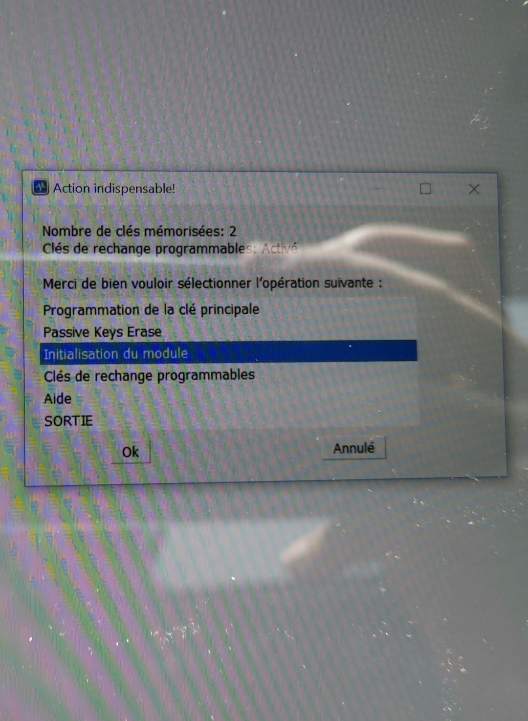

Re: How to program PATS using FORScan v2.3.*
Hello,
I bought an extended license of forscan to reprogram the modules following replacement of injection pump on focus 2002 TDdi. Unfortunately it does not work. It puts me "access denied" or "out code not correct", I see on the tutorial of your site that there is the possibility of using PATS LOGIN CALCULATOR V1, but I can not find anywhere. I tried login calculator on the internet which gives the code in from the code out, but it is not recognized either.
Please help me ... the car has been immobilized since ...
My forscan is version 10.3.22
- Screenshot_20190603_193139.jpg (268.93 KiB) Viewed 5747 times
- Screenshot_20190603_193125.jpg (189.16 KiB) Viewed 5747 times
- Screenshot_20190603_193106.jpg (239.95 KiB) Viewed 5747 times
- Screenshot_20190603_193027.jpg (492.16 KiB) Viewed 5747 times
I used PATS login calculator on autokeyprog. It's the same thing it does not work. Either there is a problem somewhere or it's just a circle to pocket money ...
- Screenshot_20190606_161149.jpg (378.78 KiB) Viewed 5745 times
- Screenshot_20190606_161141.jpg (485.18 KiB) Viewed 5745 times
Screen of incode generator
- Screenshot_20190606_161331.jpg (300.26 KiB) Viewed 5744 times
It works now
