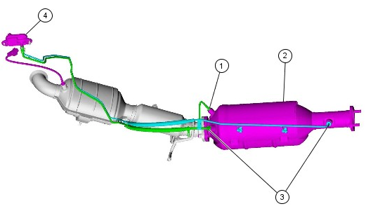

We think in you case you will not be able to get more from a computer diagnostic, so it is a time for visual inspection and land-based tests.
DPS sensor is just a small box with 2 hoses connected:
1 - temp sensor
2 - DPF
3 - Hoses from DPF to DPS
4 - DPS
Picture is for Focus Mk2 2.0 TDCi (DW)
So you should check these hoses first of all, they often have a problems. If they are ok (no hole/leak, no contamination), then probablty the problem in in the DPS itself.
1 - temp sensor
2 - DPF
4 - DPS

Disconnected the dp sensor and removed it from the car. The upstream pipe has been spirting oil or liquified exhaust vapour (not sure which) into the port on the dp sensor. As a result it is completely coked up with carbon. I have scoured and washed the sensor in detergent. So much crap came out of that little sensor i was amazed. After leaving it to dry thoroughly, i connected it back to the car. The reading has gone from 54kpa to 39kpa. Unsure if the car is cured now but i will see. I will soak the sensor in something stronger to clean the internal chambers of the sensor 100%. Common sense is telling me this should bring it down to a normal kPA reading and car will be fine. Whatever is causing oil to spurt up the upstream pipe is another story entirely i will need to address later.
